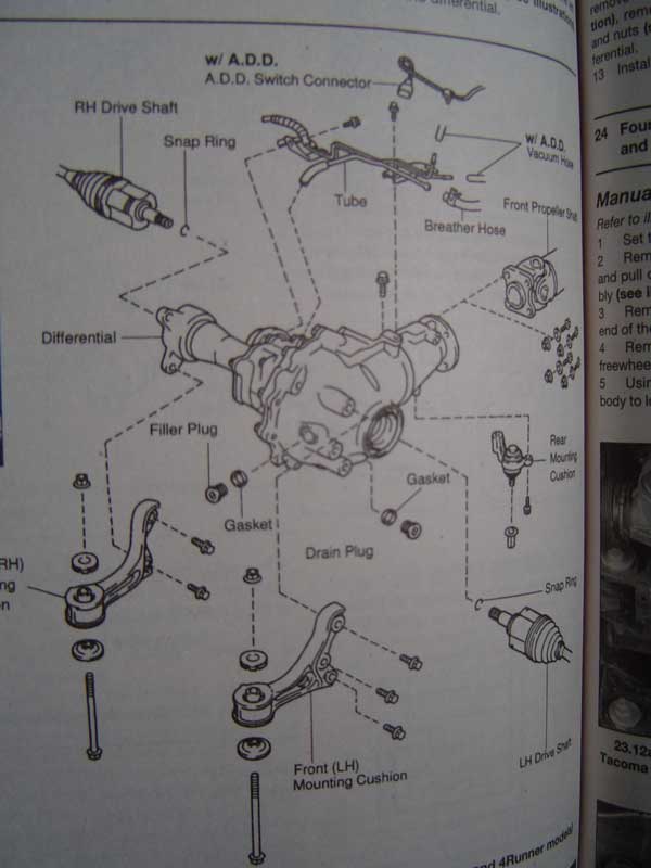

    I have managed to change the oil in the rear diff transfer box and auto box but came to a halt when faced with the front diff. Could someone help me please I just want to check before i drain and fill. I removed the sump gaurds and looked for similar drain plugs to the others the only thing I can see is an allen plug which looks like the drain plug this on the right hand side looking from the front(no allen key to fit though). Then the filler/level plug looks as though its on the left just above the drain. I didn,t drain it until checking here as it the difference between the two plugs didn't look much as though it wouldn't hold much oil. Well not the 1.9l it says on the service table I have.

    Filler is the one on the top right, drain is the one below it but facing sideways towards the right (when looking from the front).
    Hope this helps.
      Thanks
      Thanks for the help the hardest part was finding a 12mm allen key I ended up buying a set.
