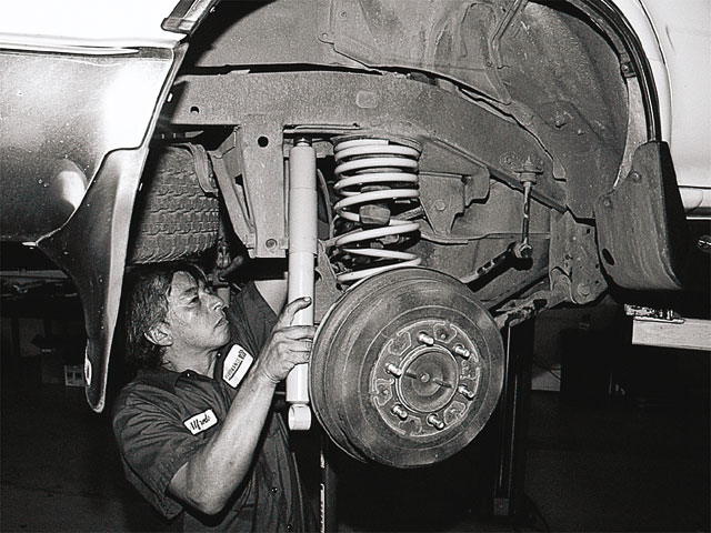

                        rear was OK, one side is fiddley due to the panhard rod mount. Not done an IFS front before but looks fine from the pics.
                        Only tricky if the top nut rusts onto the thread.

                              Changing the front shocks is easy. The back is harder as access to the top retaining nut is limited. Unlike this guy I dropped the spare down before starting the job.
