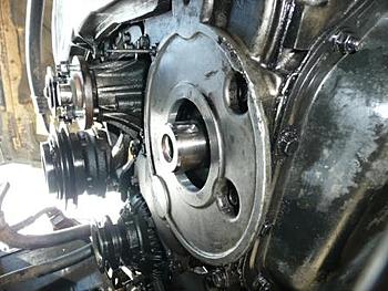

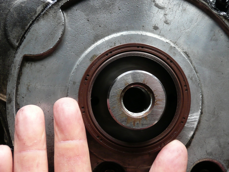

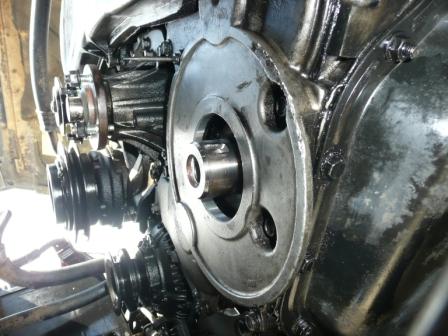

        I've added a couple of pics which may help. One is of the seal held in front of the housing. The diameter of the housing aperture is 68mm - the seal is 72mm so needs to be pressed into this hole?
        The diameter of the nose of the crankshaft protruding through the housing is 36mm - but the seal inner diameter is 57mm so I'm not sure what I've got wrong here.

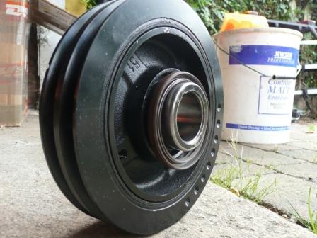

        The other pic is of the seal sitting around the flange of the crank pulley, where I thought it had to provide a seal. Again, the seal is 57mm diameter but the pulley is 50mm.
        There's clearly something wrong but I'm not clear what. Have I missed something altogether?

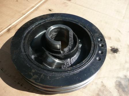

        (Edit - the car has a manual transmission, but don't know whether that makes any difference to the engine side of things. I've also attached a pic of the broken old pulley, which is the same design as the new one I've got, just for info)

          I think I know what the problem is. Your pic shows a couple of semi circular sections at the top left which are where the oil pump is and not the crank. Are you trying to put a crank seal in the oil pump housing hole? The diameter of this is 68mm. Not sure of ID.
          Ignore the harmonic balancer (crankshaft pulley) when installing the crank seal. As I said before the seal is for the crank and housing. The HB (CP) is outside this.
          Nev

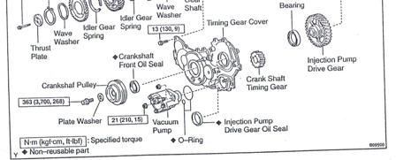

              I ordered the seal based on the manual I've got (Toyota 1KZ-TE Engine Repair Manual). Please could you have a quick look at the attached picture from the book. "Crankshaft FR Oil Seal" behind the "Crankshaf Pulley", "Plain Washer" and bolt.
              You can see from the previous pics where I'm trying to fit a new seal (the wrong one it seems) as the old seal was torn apart when the pulley cracked up. Should I order a different seal then? If so, could you give me it's correct name (part number would be perfect).

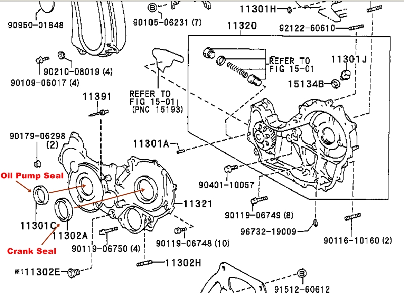

                    The diagram below is what I believe is where the seals are so if I got that wrong maybe someone can tell me.

                      Nev, what you've labeled oil pump seal is actually the crankshaft pulley seal, crankshaft seal is actually the fuel pump pulley seal.
                      FYI, the oil pump is that gear you can see in the back of the timing gear housing.
                      Hope this clears things up.
                        ok. I guess you know better than I do and after looking more closely at the diagrams, it makes sense. I have also seen where a lot of others refer to the 90311-58006 as the crank seal so that helped confuse me.
                        Nev

                            So, as far as I can follow, I need the crankshaft pulley seal, which makes sense against what I can see on the car.
                            The seal I've got (90311-58006) is not the correct seal for this application. I'm not sure what it is actually for, but I'm not too bothered right now.
                            The seal 90311-50017 does appear to be the correct size given the hole I have to fit it into and the size of the pulley it has to seal against. Is this seal confirmed as being the "crankshaft pulley seal" please?
                            Thanks
                            Rich
                              It seems like the 90311-58006 is the fuel pump seal and the 90311-50017 is the crank seal according to Tony. I would go by what he says.
                              Nev
