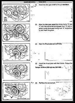

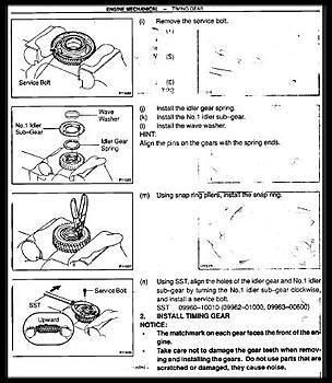

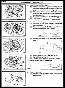

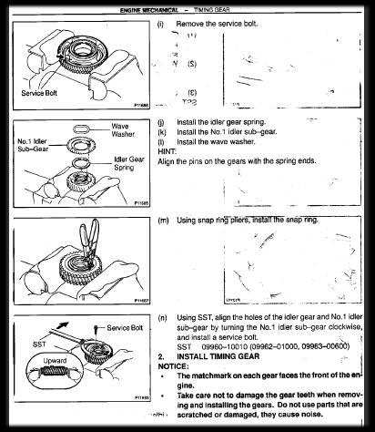

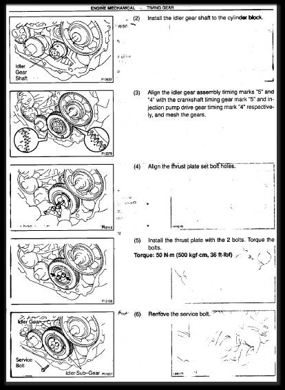

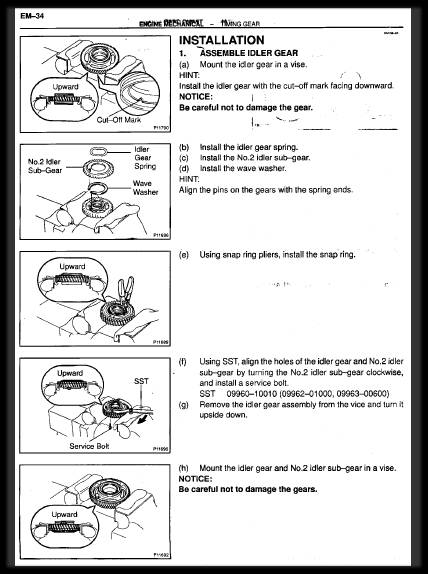

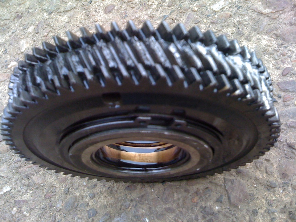

    It's not that hard - download the manual so you can see how it all connects. My timing gears were fitted wrong so I had to swap injector pipes around and remove the idler gear to move all the cogs to line up - they're numbered. The idler gear is sprung and needs putting in a vice to align its 3 separate cogs. The manual shows how.

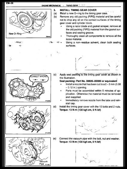

    Buy new seals for the crankshaft and injector pump as the timing cover comes off.
    Rob.

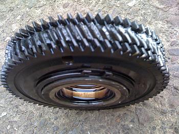

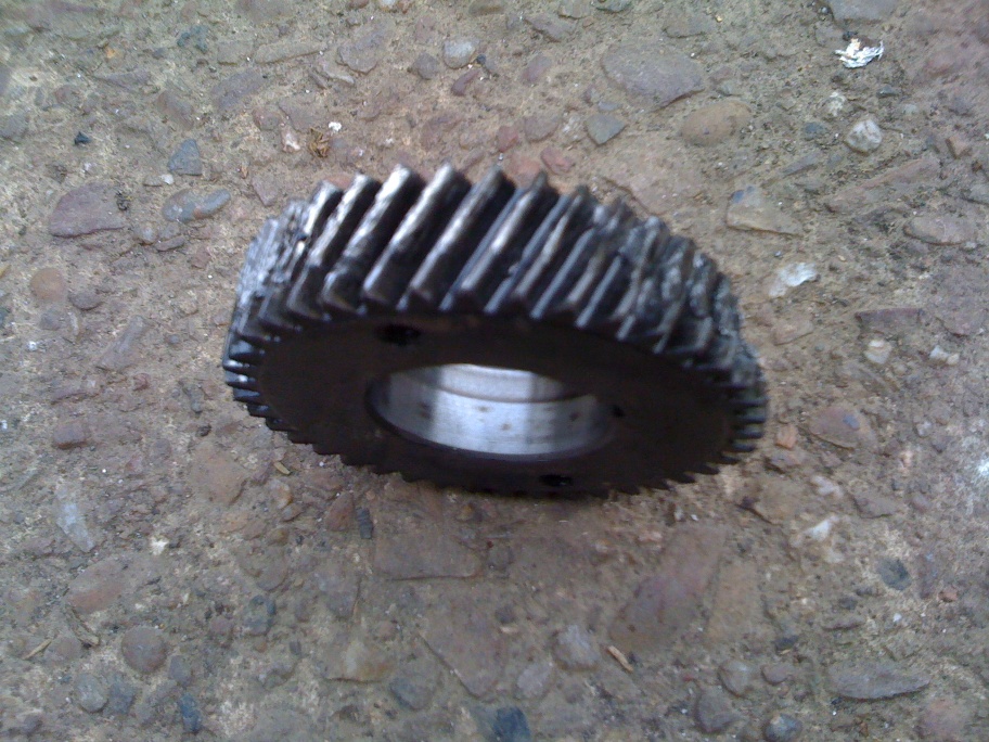

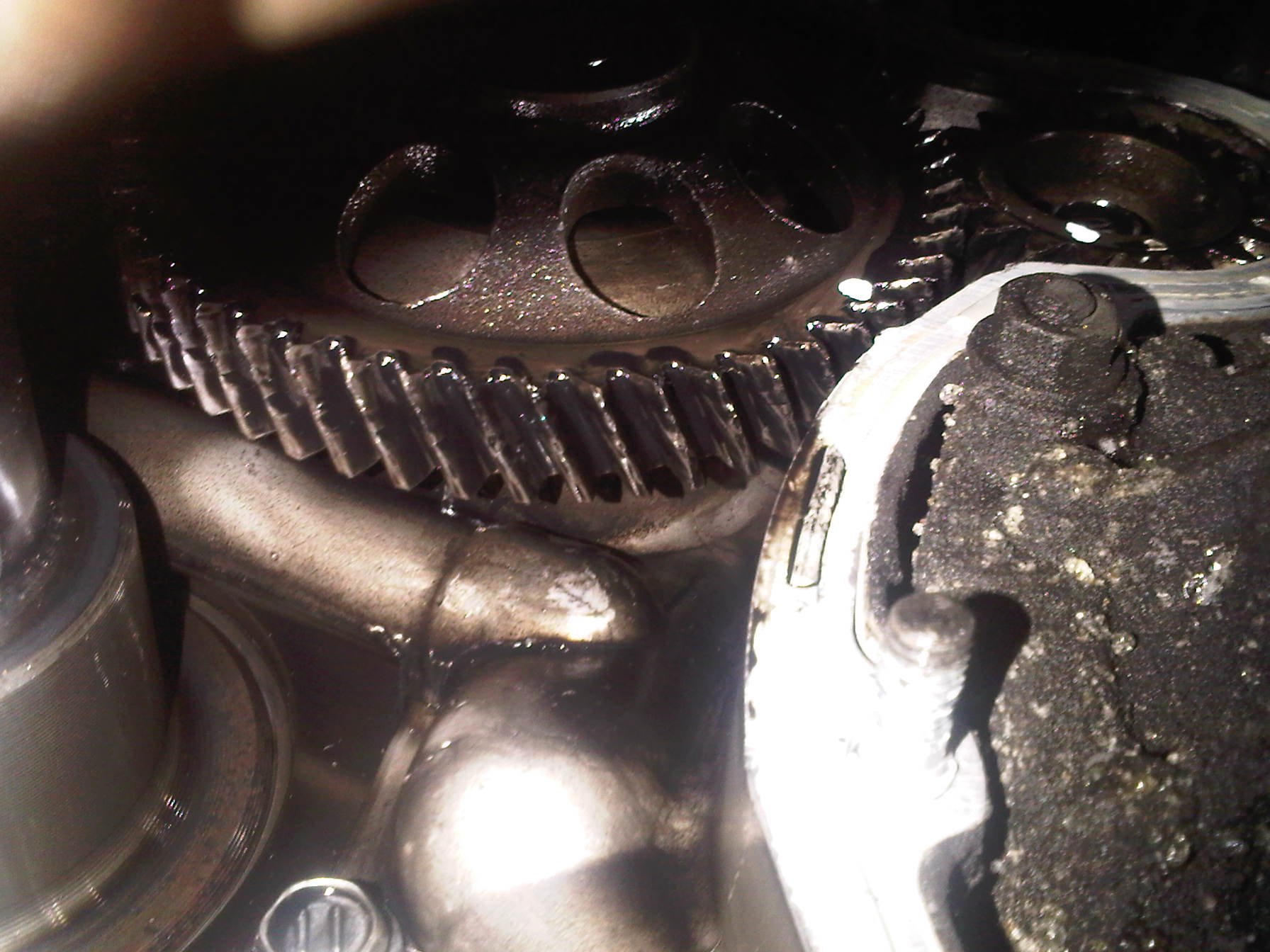

                    Ok 3 of the cogs are in a right mess I've taken a few pics.
                    God knows what gave way.

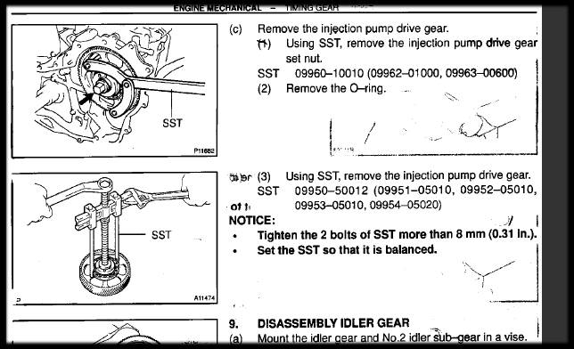

                    Does anyone know how the oil pump cog comes off??

                      I don't think you can't get the oil pump gear off, its part of the timing gear case, and it all has to be removed.
                        Blimey! I take back what I said about the gears....

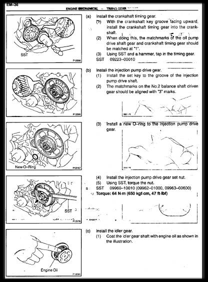

                        The manual says just undo the nut and pull it off with a puller...

                            Rob the oil pump cog doesn't have a nut on it, thats whats confusing me. It's flush with the shaft. I think the pic you uploaded is the Fuel pump cog mate.

                              Sorry Tony just noticed what you said about the pump cog..............not as easy as I had hoped for then, if it wasn't worth the effort I would just break it but I feel it still worth me putting a few hours into it.
