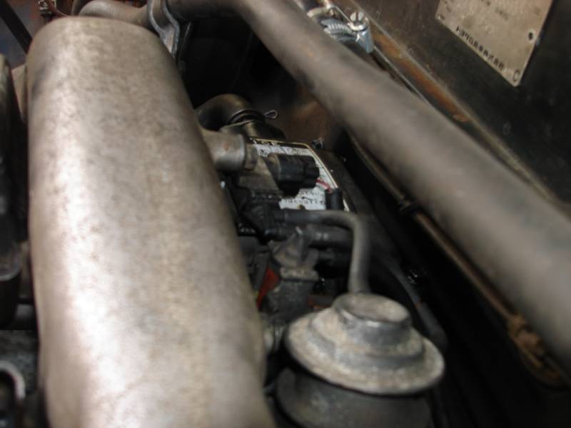

    1 goes to the egr valve (flying saucer looking thing) and the other goes up to the top of the engine behing the ally intake tube.
    edit - if my hoses are right as this engine has been messed with
    hth.
      Thanks mate for taking the pics but I am still not sure from this. The one I have remaining will go to the right hand inlet I think but still not sure about a connection to the other - if there is one!! Like I say, I only have one spare vacuum pipe!!! All of my vacuum pipes are connected correctly, and it's just dawned on me whilst I am typing that this was the one I took off and blanked years ago as the 'easy' EGR mod! I will see what happens once I try and start her up!

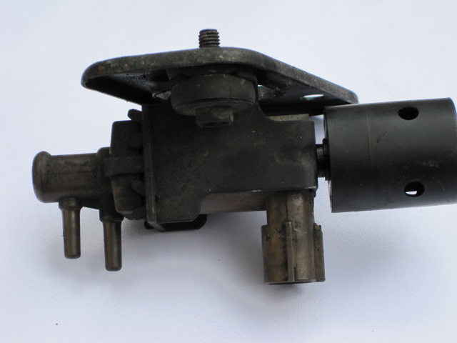

        http://www.hiluxsurf.co.uk/forums/at...3&d=1108663734 is this what you need?
        The sh$t gets deeper ...but still swimming
          Originally posted by wiggy View Post
          That's for a 2.4 engine.
            Yeah, mine's a 3.0 Looks like I was right, connected everthing up as I thought, finished putting back all of the airbox system, topped up with water and oil and she fired up on the third attempt, so well pleased
              Oops that will teach me for posting in a rush! .....Anyone got one for the 3l then?

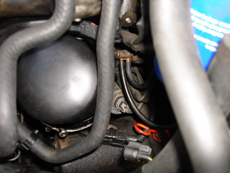

                I never found one when I searched for my 3.0 ....
                  If you have taken off the EGR pipework and blanked the holes, you dont need this either.
                  Fold the plastic/rubber pipes over and tyrap.
                  Just leave the bits with wires connected and throw the rest.
