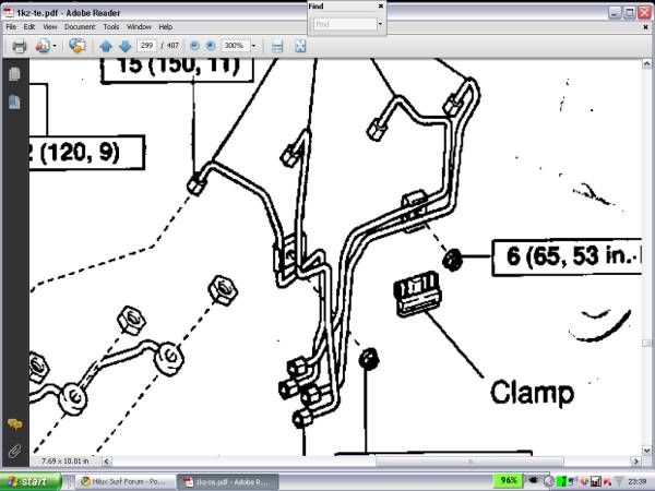

On my 3.0 project I just went to fit a new no.1 injector pipe. It looks like it should fit on the bottom left pipe on the back of the fuel pump, but mine is fitted to the top left.
This seems to confirm a problem I had when I did the cambelt a couple of weeks ago - none of the marks lined up properly.. esp. the injector pump one.
Can somebody confirm the correct order of the pipes at the back of the pump for me?
I believe they should be:
Top left: 4
Top right: 3
Bottom left: 2
Bottom right: 1
Seems right in the attatched pic.
If mine are wrong (I'm almost 100% sure they are) then is it just a case of line up the crankshaft and cam pulleys, take off belt and turn fuel pump pulley to it's timing mark, refit belt and injector pipes in the right places and all is good ?
Thanks,
Rob.
Edit : Seems it's gear driven so I've got to remove the fuel pump and refit correctly ?
