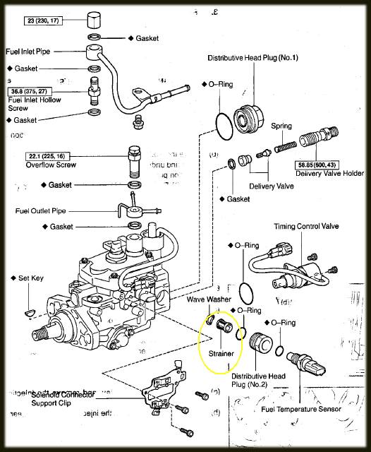

Hi All,
Does anyone have a photo, or a link to one, showing the location of the thimble type filter which is apparently fitted to the injector pump on the 3.0L gen 2 please?
Thanks
Alan
