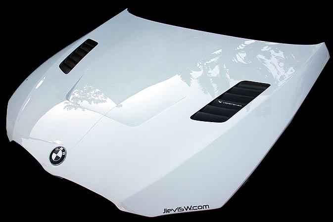

do you know where i can find vents like on the bmw in the pic? also i was reading one of your older posts from '06 how you painted some of you undercarriage red when fitting the rear 2" lift. i will be fitting my lift in the next couple of days (or at least trying toOriginally posted by BUSHWHACKER View PostFit hood vents.

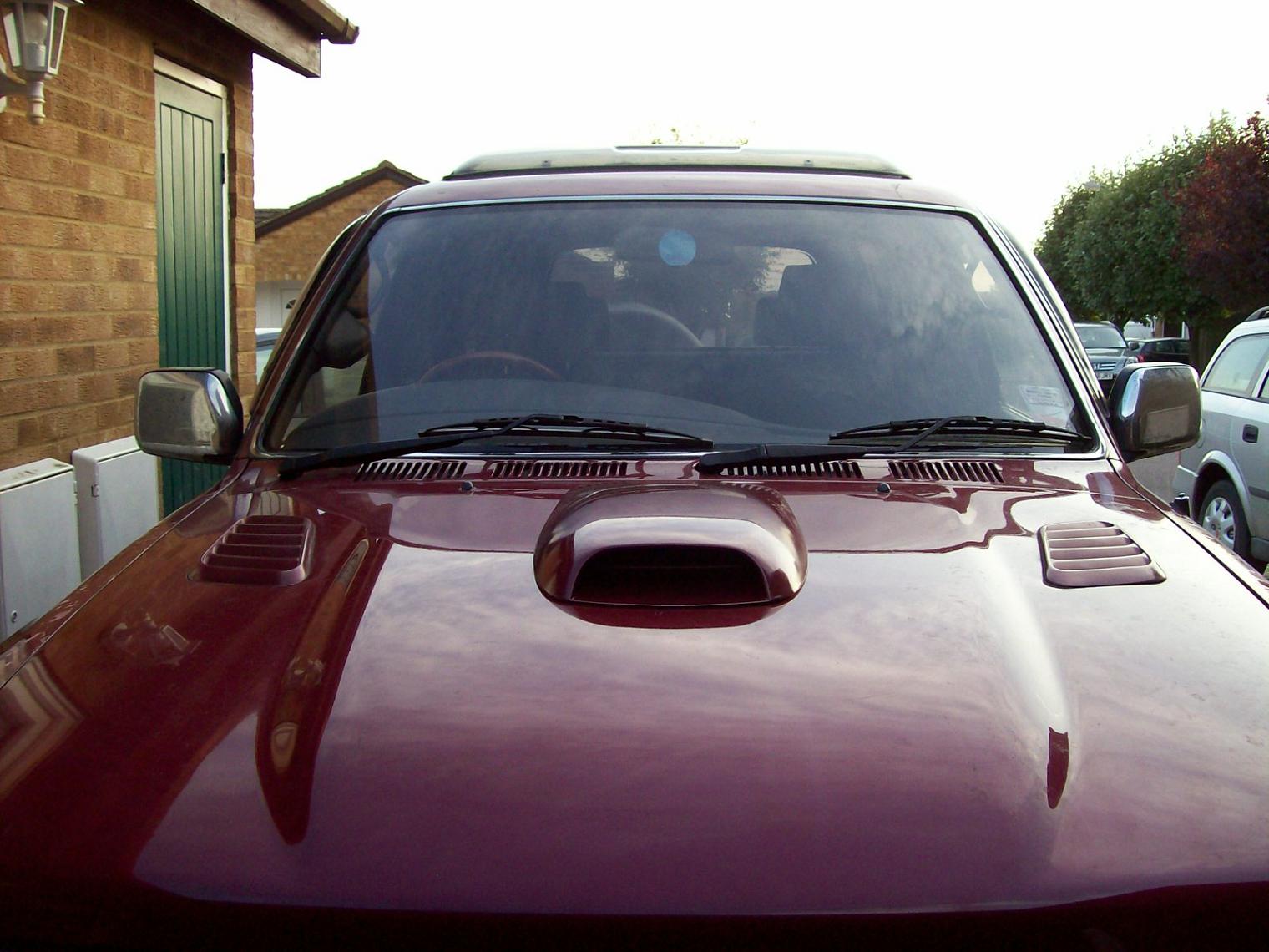

Fit them about three quarters up from the front edge of the hood for best results, directly above the turbo and the same position the other side, kinda like this.......
