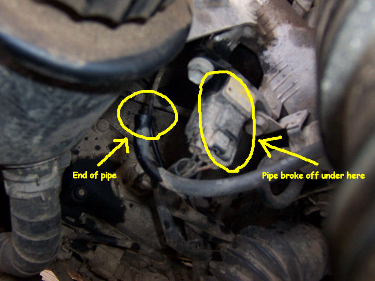

        Just found this. Next question. As the plastic nipple the pipe attaches to has broken off, does anyone have one of these doobries to sell me?!

          That's the Turbo Pressure Sensor part number 89421-60030.

            hehe, that'll explain the lack of power / better fuel consumption then
            Cheers Nev.
              Replaced the turbo boost sensor today (thanks Richard!)
              Truck now goes like... well... not stink cos these things dont, but its much less of a slug than it was!
