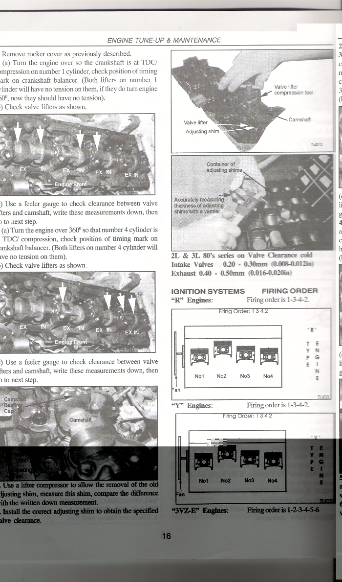

I need to do my valve clearances on my 96 3.0 4runner the Haynes
manual says that the clearnace should be 25 inlet 45 exhaust, however the manual is not for the UK 4runner and upon looking at the pictures the inlet and exhaust valves are in the wrong places!!
rang local toyota
garage they will not supply valve clearance details
spoke to toyota
in Epsom Surrey they cannot help either
Any ideas?

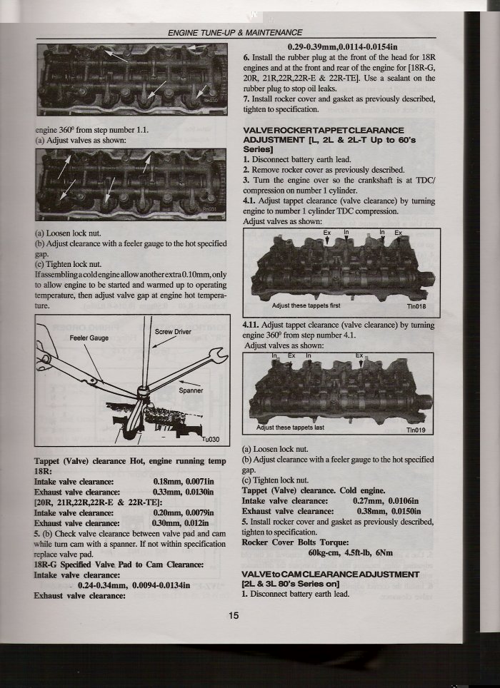

thanks Linda, unfortunately those relate to adjusting tappets, mine are shims, and the inlet and exhaust sequence is different on mine for some strange reason!! can i be cheaky and ask is there any information on page 16? i notice at the bottom of 15 it just starts to cover the 3.0 engine
