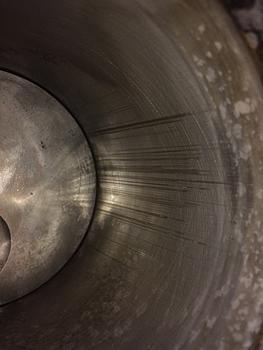

only issue I can find is some deep vertical scratches in cylinder 2, like the piston ring is shot may be or it ate some metal at some point will attach a photo if I can.
