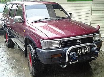

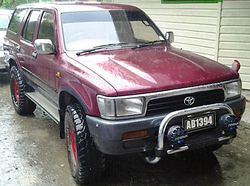

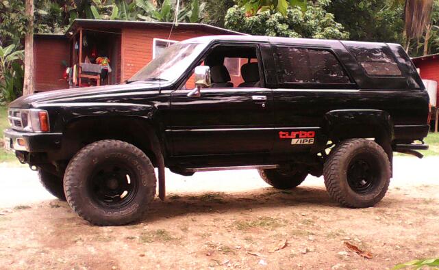

                        Hi guys, sorry for the terribly late response but I enjoyed my truck so much after having it fixed. It was running mint from March up until July, when I decided to sell it.
                        After I sold it I got myself an 87 Hilux Surf in almost faultless condition with a 2LT mechanical engine in it.
                        It was sad to see my old baby go after having it for the past 10 years but I welcomed my new one with open arms and it has been very good to me since July.
                        Thanks again Mates
                        I've attached a pic of my current 87 and my old baby 93 which you guys helped me fix
