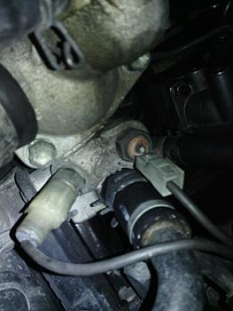

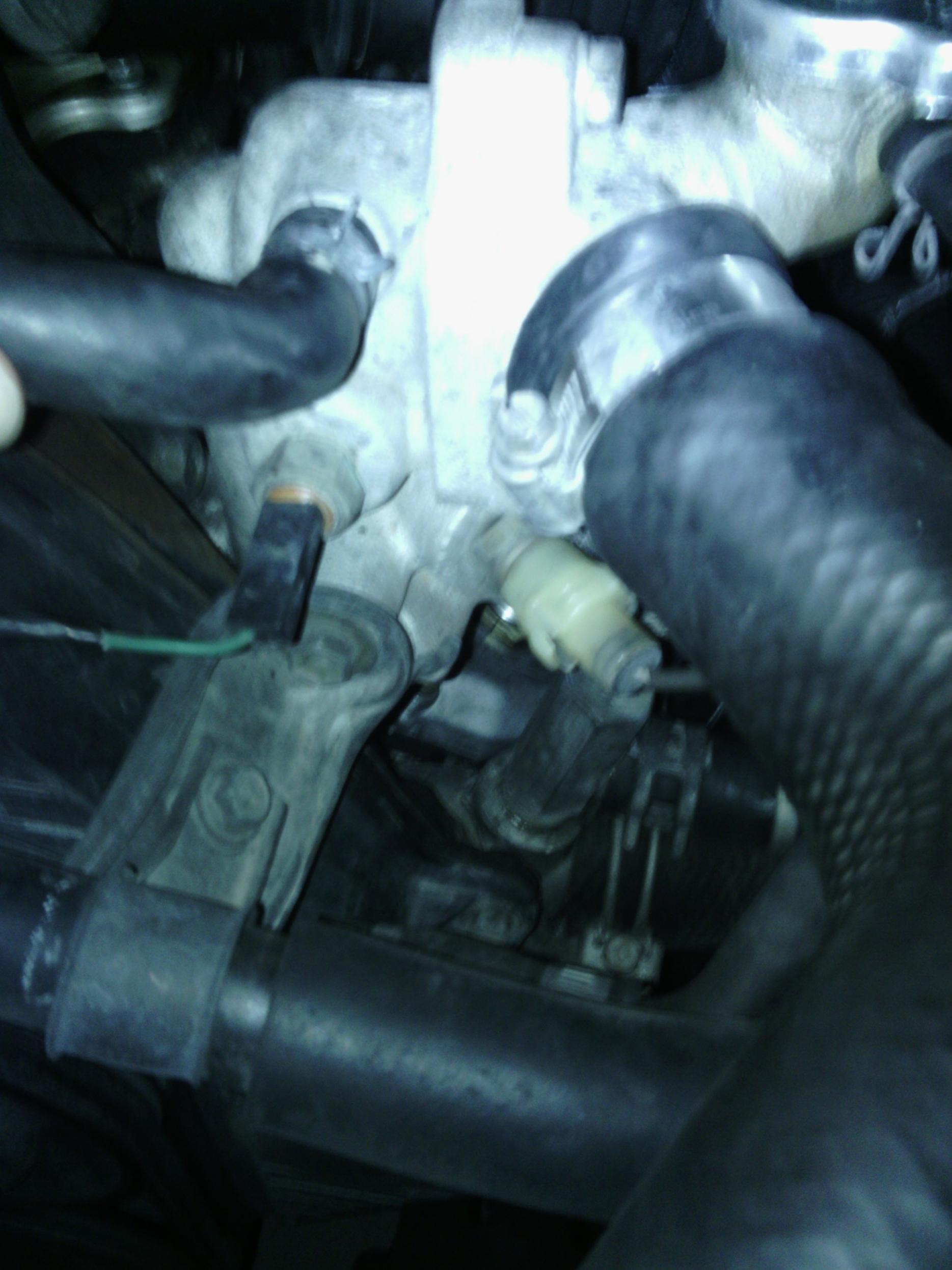

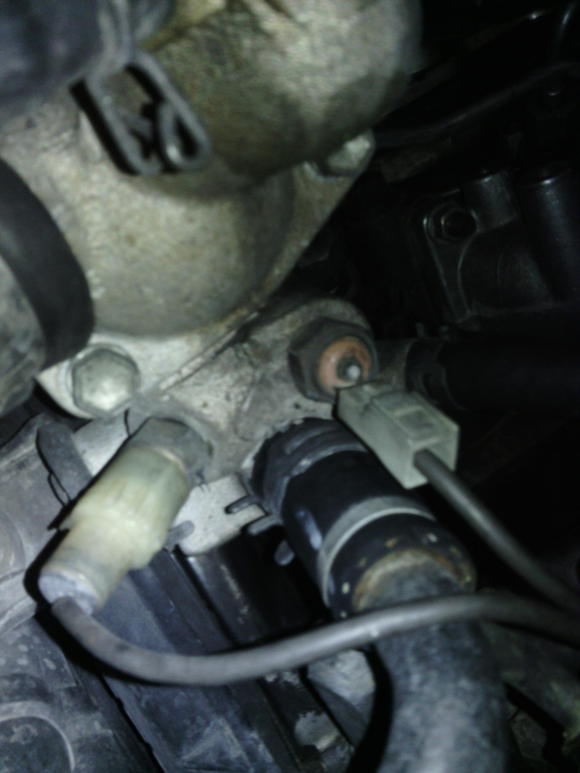

        I have attached two photos. the first is a front view. you can see one sensor at the front and one to the right. the second photo is looking at the side where you can see the right sensor I mentioned above and another sensor. Nev on looking at the front of the radiator I see there is no thermofan. just a fan that looks like a airconditioning fan. Can you tell me what each sensor does?

          I guess it is the front sensor with the green wire that doesn't show on that other photo posted.

            Side one should be Temperature Gauge. Front should be Thermo Fan (air con fan) and maybe the other is the Coolant Level Sender. If you unplug this one and start engine do you get any warning light?
            Manuals usually have two. One at front for Thermo Fan and side for Gauge. Autos usually also have two. At side for gauge and in the position of your mistery sensor for the Thermo Fan with a plug in the front position.

              so the middle side sensor with the big plastic plug on it is the temperature gauge sensor? and the one on the side furtherest back is for the thermo fan?
              And im assuming the front one with the green wire is the mystery sensor? Is this usually the plugged up spare hole that people talk about on 2.4s?
                Nope. Green wire is Thermo Fan Switch. Passenger side should be Temperatuure Gauge. Mystery sensor is the one in centre.
                Nev.

                    The blocked hole is usually only found on autos. Autos have the extra hole where your mystery sensor is and usually has the Thermo fan switch there whereas the manuals without this extra hole have it at the front.
                    As I said before, the extra may be a coolant level switch. To confirm the others are gauge and thermo fan just test them. Remove gauge plug and temp gauge should not work. Remove what I think is thermo fan switch plug and with engine running and air con on the thermo fan should start.
