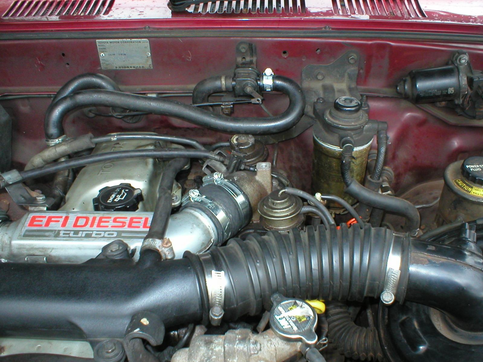

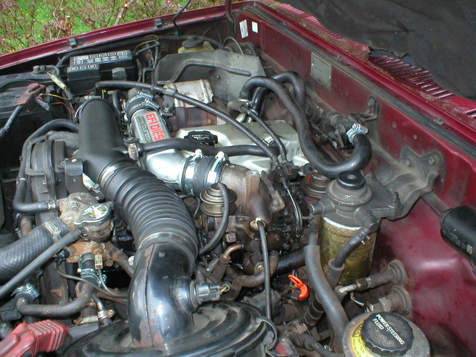

fitted new rocker cover gasket & found vacuum pipe blanked with tape.
pipe no 90999-92002 where it joins the metal pipe going to the vsv,
removed tape & refitted. engine runs but stalls when revs drop.
guess it's blanked off ref a sensor fault, but which sensor ?
robert
