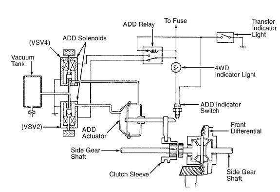

Hey mate,
Well when I bought the car the 4wd worked.
Then all of a sudden it took longer and longer to disengage before finally just staying in 4wd.
My mechanic had to apply direct power to the transfer case to get it out of 4wd.
I later found a vacuum line unplugged but I suspect this was always unplugged because when I reconnected it, the truck would shudder and die after a minute.
It sounds like an electrical problem to me but my slack auto electrician couldn't find anything wrong with it and it had him boggled.
I bought 2 2nd hand vacuum solenoids and installed them but so knows if they are working, apparently one of them is constantly drawing air.
