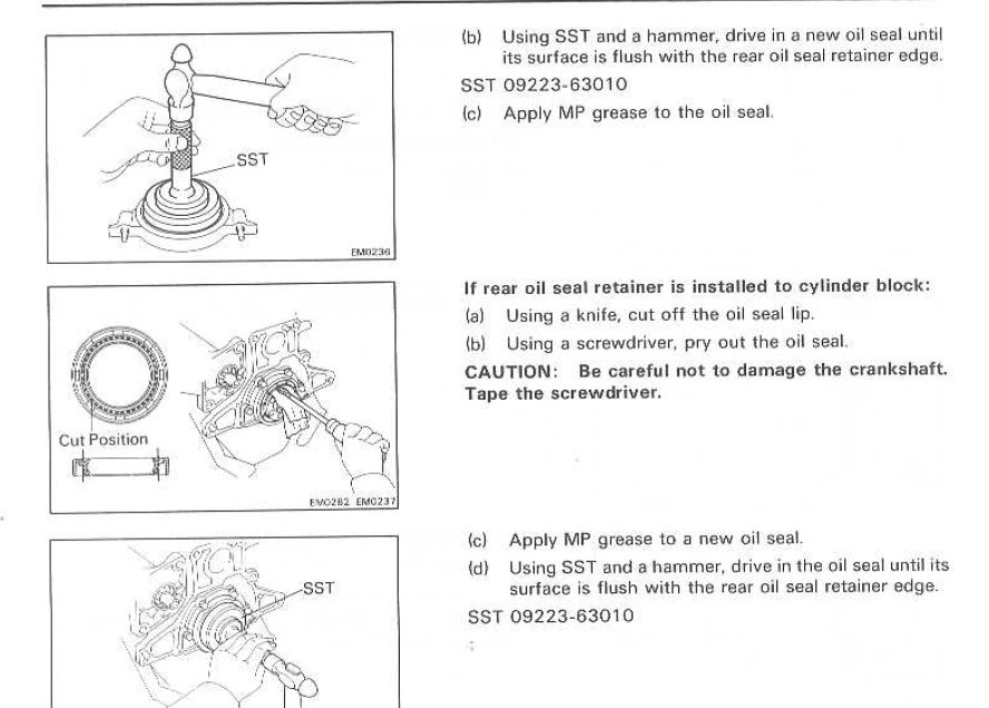

So i'm just doing the clutch on my 2.4 surf and am at the rear main seal now.
I removed the old one and put the new one in there. Now my question is how far do i put it in there? Do i keep pushing it in till it stops or will it stop? I made a mistake and did not look to see if there was a ridge that would eventually stop it.
So does it have to be flush with the outer housing or should i push in farther?
