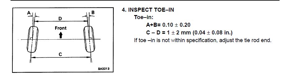

    Just removed my OSF outer track rod end, new one on order, I counted the turns when I removed the old one, what is the recommended track width mm toe in or out?
    (I normally set up tracking myself with an adjustable bar)
    http://daemon4x4.org/board/topic.php?id=73
    Hope that helps
      Thanks for that, any idea what it is in millimeres?
        Pretty much have them both dead straight ahead.
          Thanks very much, just what I was looking for.
