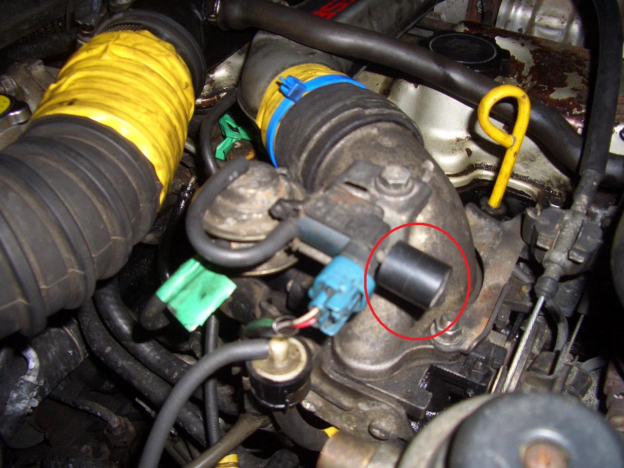

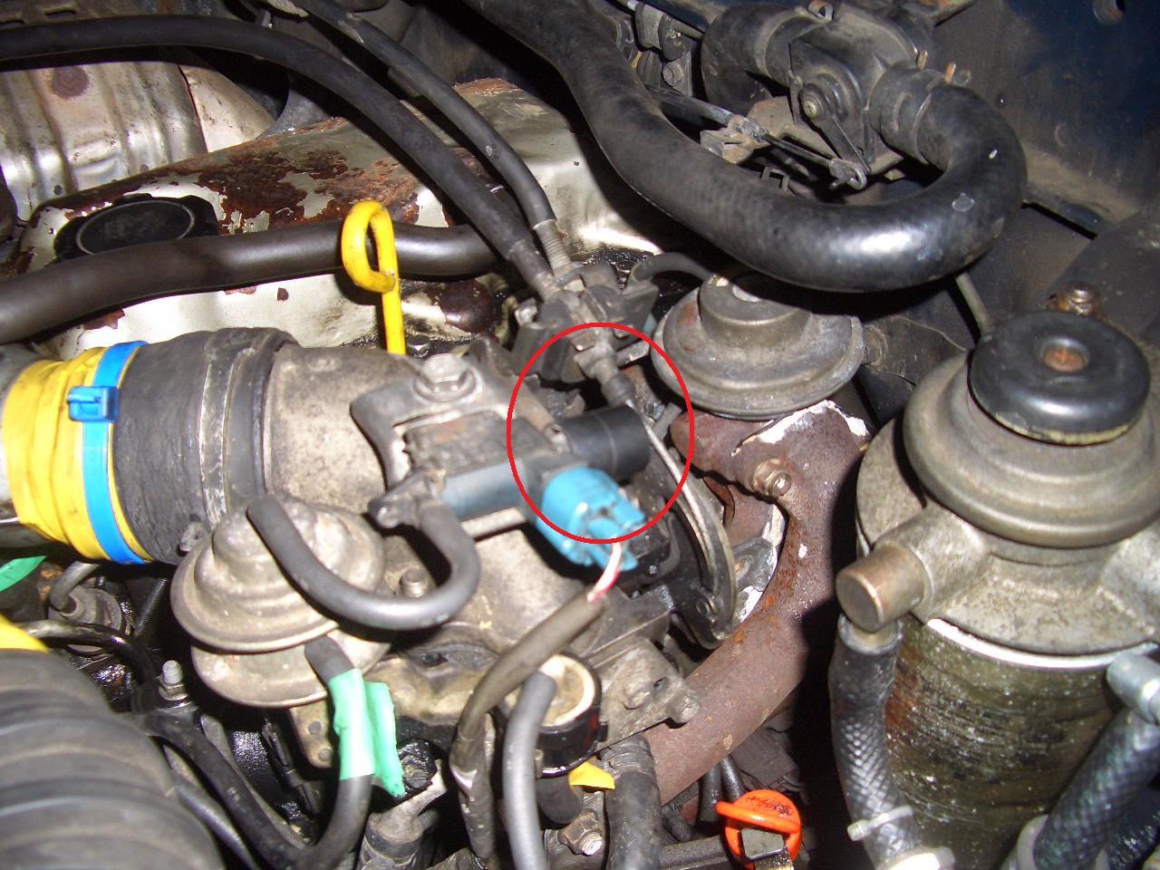

Finally - does anyone know what the black knob sitting on top of the throttle housing does - it attaches to a diaphragm which controls a very small flapper next to the main throttle flapper - but can't work out what it adjusts..?
Anyone got any ideas?
