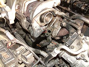

    Please excuse my ignorance but my mechanic and I are scratching our heads.
    My beloved Surf became victim to a cracked head about 18 months ago. A recommended mechanic came and stripped the engine and established that the head was indeed cracked. Anyway to cut a long story short the Surf has been sat in my barn since then. I recently bought another head etc and tried to contact the mechanic to start the rebuild. Problem is he has since moved and cannot be contacted. I have managed to find another mechanic who was prepared to undertake the work. He was faced with a stack of parts etc and has started. He was doing really well but is struggling to identify one of the pipes as he can't work out where it should attach to.
    There doesn't seem to be anything on the table of "bits" that it should attach to.
    Can anyone please give us a clue?
    I have attached a couple of pics.
    Thanks in advance to anyone who could help.
    Ian

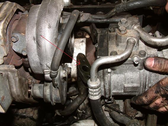

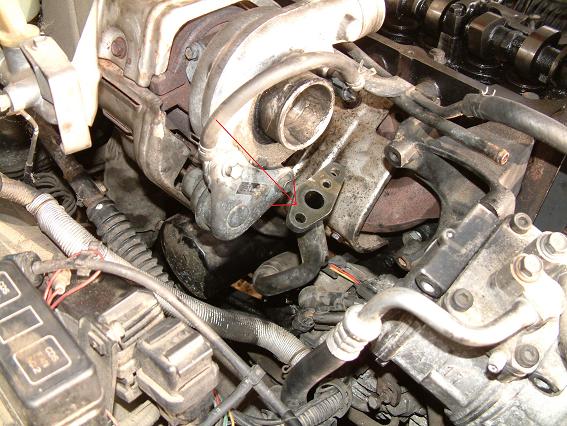

    That's one of the oil pipes (return I think) for the turbo, it connects underneath the turbo.
    I think you can actually see where it connects to in your first picture, I see a stud below the oval cover in the turbo bearing area.
      Concur and it's a bitch to put back on, you need quad jointed fingers to do it!

        That's it! I can see it now!
        The wonders of t'internet!
        Thanks guys

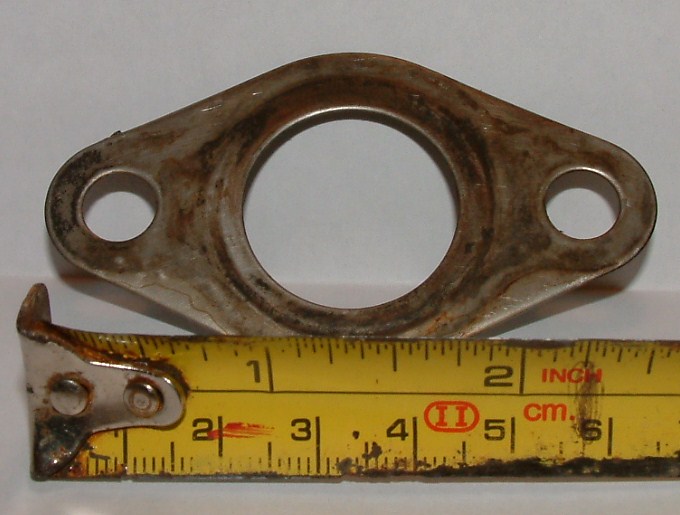

          Then I discovered sitting amoungst odds and ends on the workbench a metal gasket (photo attached). I have a feeling that this is from the turbo oil return pipe discussed earlier in this thread. Can anyone confirm this?
          Also, could this be responsible for the engine check light situation?

            Can't be for the turbo oil lines as there are two pipes, an inlet and outlet. Got me stumped as to what is is right now.
            Nev
              Got it. EGR pipe to exhaust manifold gasket. Must be getting old, took three minutes to figure that one out.

                  Thanks for that Nev. In your opinion could the lack of this gasket be responsible for the warning light coming on?
                    No. You might have an exhaust leak though.
                    Do the diagnostic check.
