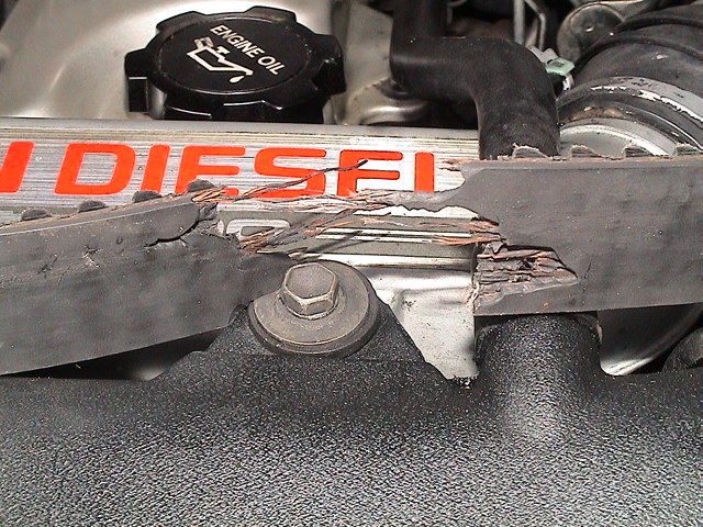

    2 hours later with the cover removed and there it was a 20,000 mile old, non genuine cam belt (which I fitted exactly 2 years ago to date) with a nice clean break accross it, the genuine tensioner still in the position I set it at 2 years previous.

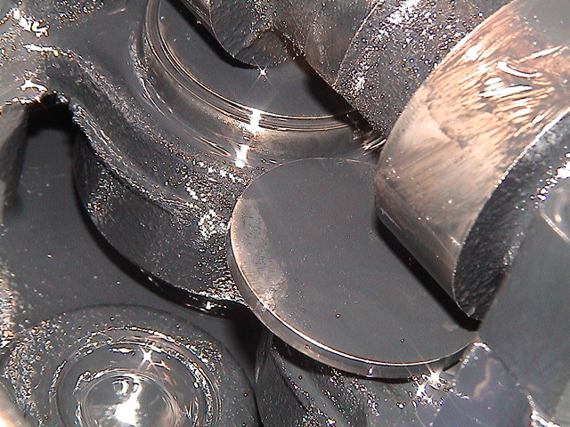

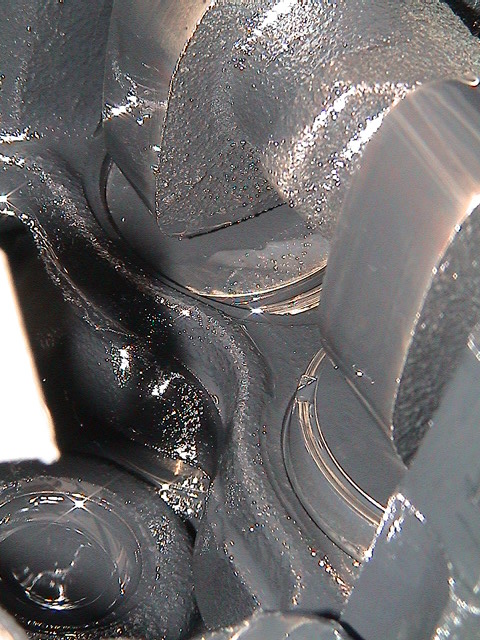

    Out of curiosity I removed the rocker cover as I could not rotate the cam in any direction by hand, although the crank turned over revolution after revolution with no resistance what so ever. With the rocker cover removed all cam lobes "except piston number 2 exhaust valve" were roughly closed. However the shim from piston number 3 inlet valve was totally dislodged and sitting in no mans land and the bucket and shim arrangement on piston number 2 exhaust valve was on one serious tilted angle (had a bent valve caused it to tip this way?) and why the dislodged exhaust shim.
    Had the shim caused the cam to jam up and in the process snapped the belt, or had the belt snapped and caused this scenario? I could understand if the cam had snapped at this point but how the hell can a shim jump out of the bucket recess, has any one experienced this on their truck (1992 2.4 manual surf, ln130). My gut feeling tells me cheap after market belt, for the sake of a couple of quid don't risk it always fit genuine engine parts.

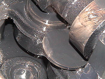

    Sorry I made a mistake, it is the inlet valve bucket and shim on number 2 piston that is tilted and the exhaust valve shim on number 3 that has dislodged (pictures attached).

      Hi mate,
      That looks expensive, but I must say the
      oil looks like it's been mixed with water, maybe
      there's been another problem in there as well,
      but we'll never know now, sorry for your loss.
      Gman.

        looks like the belt snapped, valves bent open shim jumps out ,how much you lookinf for?

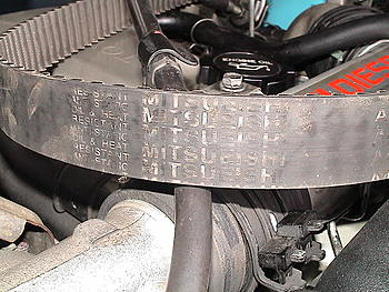

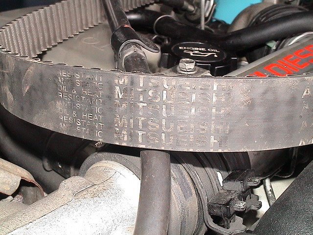

          I had another quick look inside the rocker cover today and there are definately 2 bent valves the other 6 (when compressed) return as normal, as explained this all happened less than 5mph, it might be a simple case of 2 replacement valves. If the truck had 7 seats I would be fixing it tomorrow, its been so reliable until the fitment of a cam belt made of cheese, a picture of the offending item below.
          Like I said do not skimp on cam belts,tensioners etc for the sake of a few quid it simply is not worth it.
            Mitsubishi are OEM? That belt looks worn or stretched, maybe you over tensioned it or it was rubbing on something?
              It doesn't say Mitsubishi..
              It says Mitsueishi.. I think!
              Either way.. Very valid point on not skimping on such an important part of the engine.. Especially as it is just a few quid different!
              Sorry to see it's ballsed your truck up mate!
                Aye, you could be right.
                  Looks like the belt has been rubbing on the tensioner.
                  Nev
                    Just wondering, as you skimped on the belt, did you renew the tensioner?
                      It does look like something caused it other than the belt being non toyota.

                            I disagree. That belt is worn on the outside and from your description you didn't tension the new belt correctly. Sorry, but I think you brought this on yourself by not fitting a new tensioner and/or because you didn't tesion the belt correctly.
                              I'm not sure what you call rub marks, surely if the belt had been rubbing there would evidence of dust everywhere? but not a trace, the belt was tensioned exactly as per original, when I loosened the tensioner off it went exactly to the creep mark and is still exactly on the creep mark, I've probably changed around 50 cam belts on all makes and models of cars and over 100 motorcycle cam chains with no issues, believe me I know how to change a belt correctly. I removed the tensioner this morning and it feels as good as new. Like I said buy cheap buy twice.
