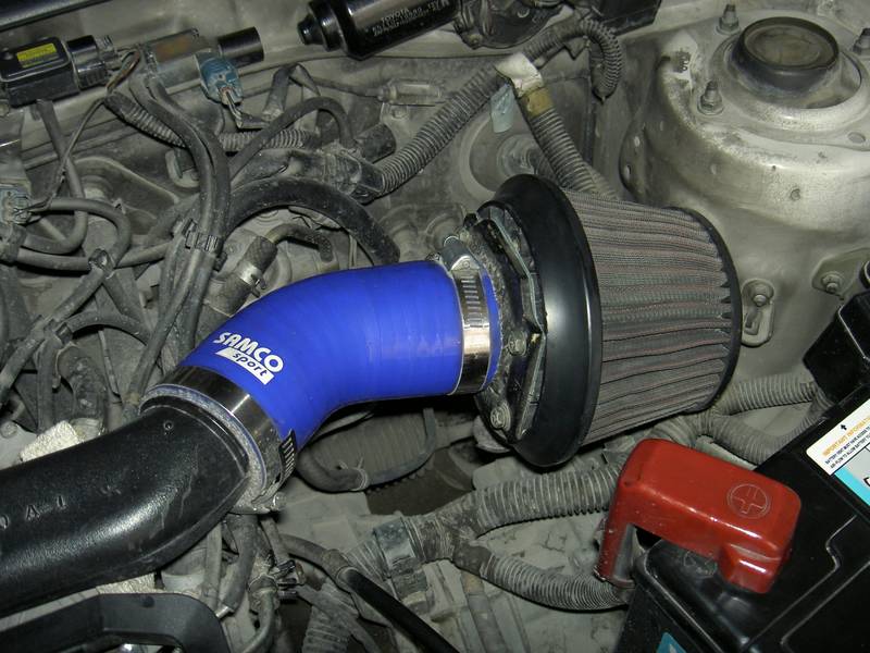

                  sorry to sound thick but was thinking of disconnecting the air filter and box and replacing with a cone filter like in the attached image shouldnt be any technical problems just dont want it to sound to much like a suped up corsa but yeah i agree the more flow the better do you agree that this should improve fuel economy and power
                    All you'll gain from using one of those is a lot of noise like you just described.
                    That filter will be sucking in hot air from the engine bay which will lessen performance and use more diesel.
                    There's a K&N filter available thats a direct replacement for the stock filter, it's more free flowing and it'll be drawing in cooler air from the front of the truck, just behind the passenger side headlight. Cooler intake air will improve performance, an increase in mpg is marginal though.
