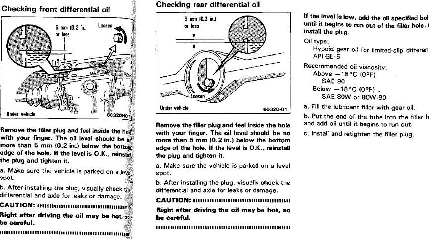

    what about doing the diff oils and auto gearbox oil to?is it an easy job?

      Diff oil is easy enough to change, just remove drain plug from bottom till empty., replace and remove filler bolt from front and top up with recommended oil to the correct level, put filler bolt back in and all done

          cheers all i will search for the diff oils level im guesing it will be the same as my rx7-fill to the bolt hole... but will check...
