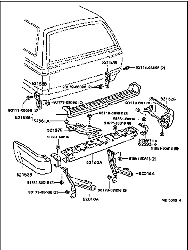

    Best way to find out is to lay on your back under the truck and have a look really.
    Basically it's bolted on in four places, two at the back and one on each side if I remember correctly.
    If you have an underslung spare wheel, it's much easier if you remove that first.
    Oh. and give all the bolts a good squirt of WD40 about 20 minutes before you try and loosen any .
      Diagram of rear bumper.
      Nev
        a double squirt of wd and be prepared for snapped bolts, a stock of 8mm would be a good idea

          Thanks all particularly Niftynev for the diagram. Suppose I will get my knuckles scraped this weekend if its dry.
