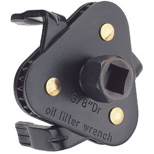

                            The filter will be as tight as F_ _ _ K buy a 100mm (4") jubilee clip and tighten it to the filter, all you have to do is tap the clip with a long screw driver and hammer, and it will undo very easily, before you put the new filter on, tighten the clip on the filter, that way it won't get lost and it will all ready be on for the next filter change.
                              these are cheap from machine mart
