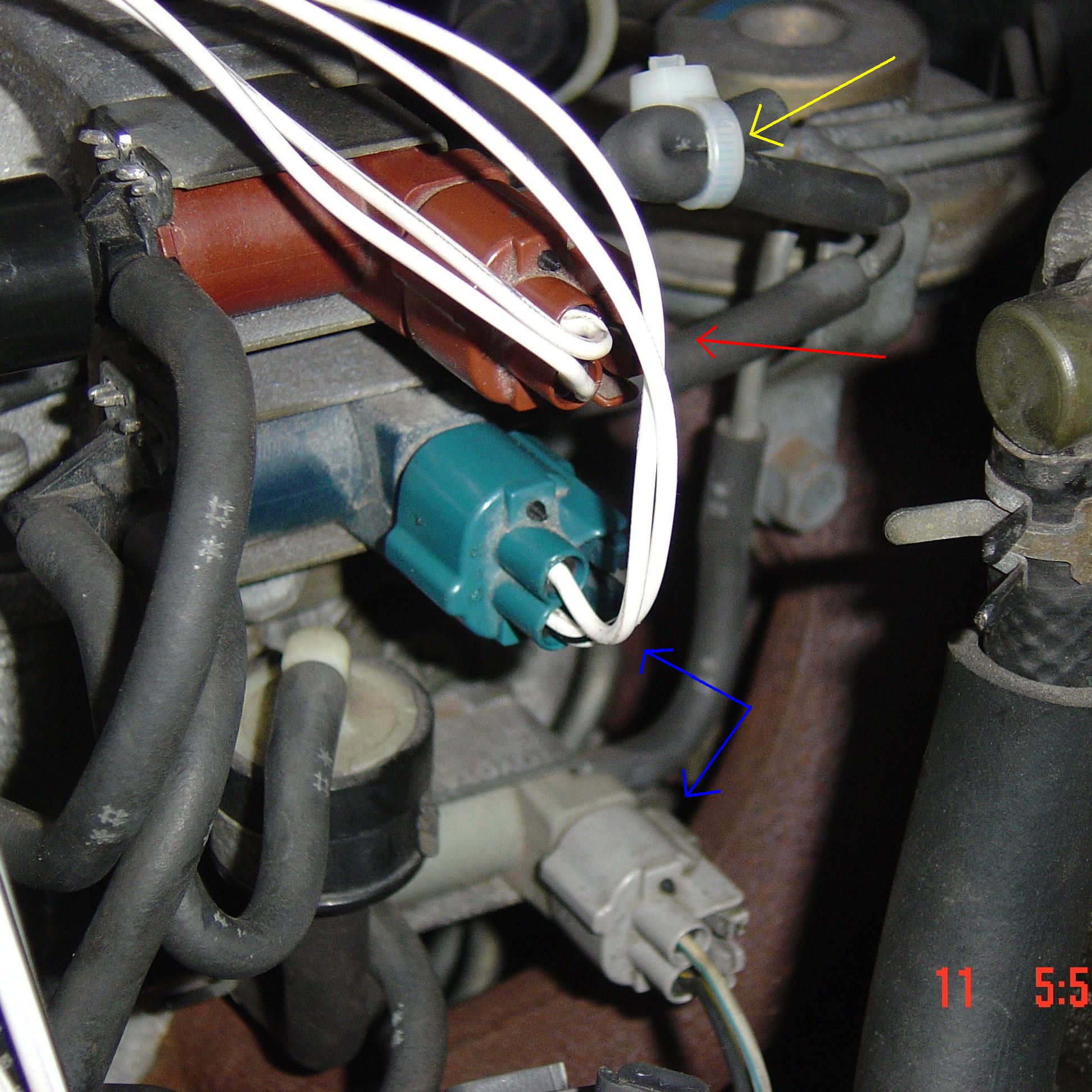

    I hope you can solve this, its driving me and my surf bonkers.
    This is difficult to explain, but here we go!
    My surf is having trouble ticking over, when she's at idle the rev's seem to go up and down as if it’s trying to stay at idle but eventually it cuts out. I’ve had to disconnect a vacuum hose in order to keep it running (please see attachment yellow arrow)
    Does anyone recognise the three switches 1 grey, 1 blue, and 1 orange? It’s the orange one that doesn’t seem to be working. The grey and blue are fed via 12vdc but there’s no voltage feeding the orange one (could this be the problem) also when you disconnect either the grey or blue and then reconnect you can hear them clicking inside, should the orange do the same if it had 12v across it.
    Any ideas is much appreciated
    Jameson..

    Have you checked all the vacuum hoses for splits etc
      yep, checked them all and they all seem to be in good order.
      I suspect its the top orange micro switch is the prob, looks like i might have to bite the bullet and order a new one, or get a 2nd hand one.
      does anyone know what is the proper name of these switchy things?
