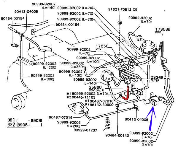

Does anyone have these diagrams, theres one here for the vacuum pipes but it doesnt label the part i need. I will put a picture, the arrow points to the part thats broken.
At least i think thats it, it has two pipes on one end and one on the other.
It is pluged in to lectrics and i recon had a spade terminal under it too.
If theres a diagram out there with both the pipes and the wires that would be ideal.
Mine broken one has part numbers on it, 25819-54060 139700-0100 E-VRC
Electric Vacuum Regulator.
