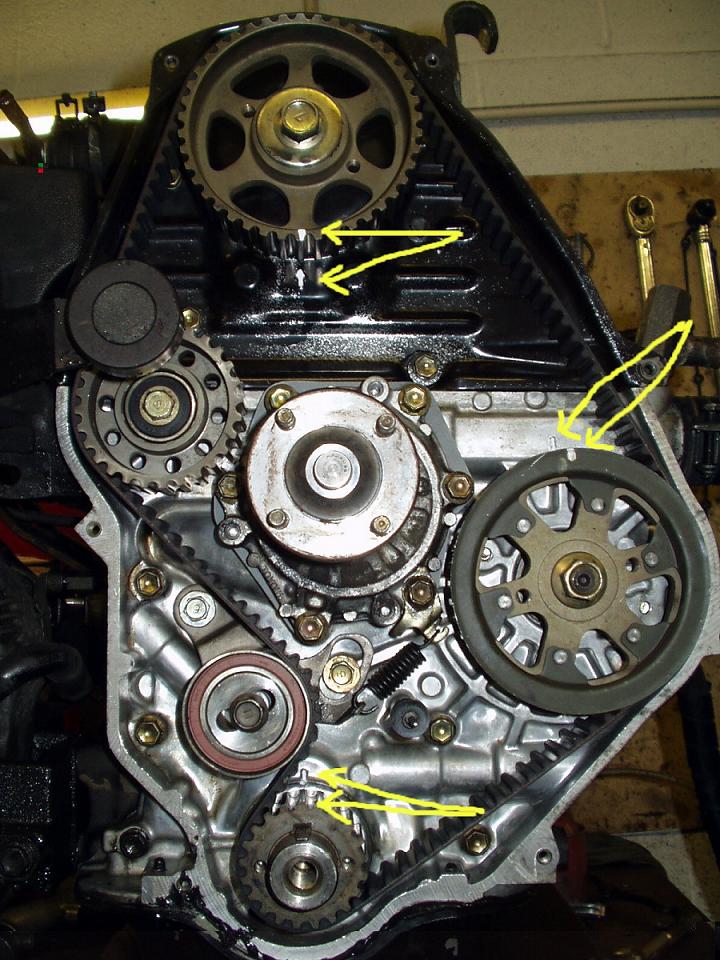

    Any ones got any pics. as i take that the cam mark is in line with the head
    And can i use 2L parts ???

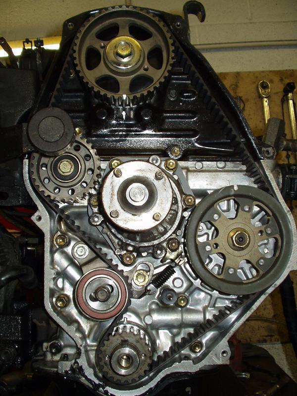

    Here you go
      Thats a 2LTE.......
        Early L 2L and 2L-T timing is, cam 3 o'clock pump 12 o'clock amd crank 12 o'clock.
        http://toyotadiesel.com/photopost/sh...ry.php?cat=511
        Have a look for the 2L - 2L-T manual on Matts site.
        Parts for the 2L and 2L-T around the same period should be the same.
