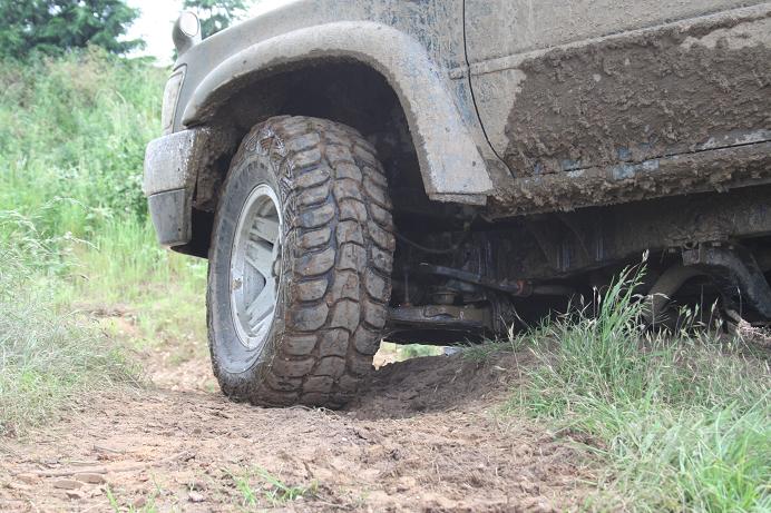

    For a cheap alternative to getting bigger tires do land cruiser wheels fit the surf i was going to use the wheels off of a same age surf as mine (the big one very square 4.2 liter one) as i have seen some i like and my tires are almost out so now would be a good time.

    They do fit and have slightly more off-set, (deeper dish) so they fill the arches better.

      Cool that was my other reason i wanted to fit them.
        i got them on mine they have a -20 offset

          They look like the ones already fitted to my surf did they do landcruiser wheels and ones for the surf?

            yeah that design seems to have been available in 15" in both -8 (surf) and -20 (lc) offsets
