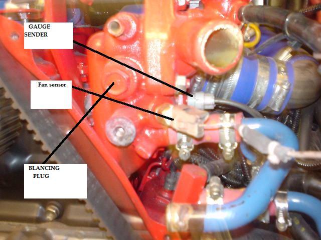

          just tried fit the part i ordered but it seems to be wrong i've just tried remove what i think is the sender and it snapped due to being rotten inside can anyone tell me if i got the right part here it looks a bit like glow plug and sits at the front of the thermostat housing any help would be appreciated cheers

                Temperature Gauge Sender is on the side of Thermostat Housing. The one toward front is Thermo Fan Switch.
