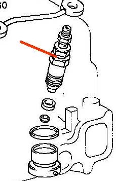

    Just got my surf back on the road and it's developed a leak at one of the injectors (nearest bulkhead).
    It's foaming between the main injector nut and the nut above it. I've attatched a pic trying to show where.
    Is it a case of removing / reseating the injector or do I need to replace it ?

    washers are £1.30 each from toyota but you will have to take the diesel return pipe off ,this means disconecting all four (beware them falling apart ).....This is the stage i am at , if it fails it get them recon'd
    Diesel bob £35+vat each them to be reconditioned
    www.daemon4x4.org
      Thanks for your reply. I've just removed all four and the washers in all of them were broken. I'll get them ordered and see how I get on.
