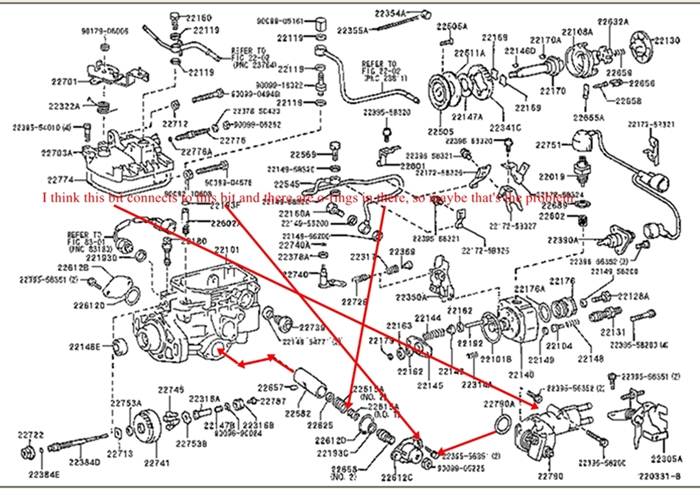

      This any help. I don't know much about these pumps.
      Nev
