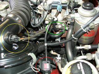

    Check the short rubber pipe, circled in green in the photo is connected. It can sometimes get oil on it, swell, and be easily knocked off, resulting inloss of boost pressure.
