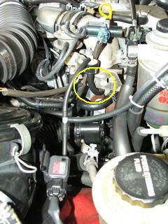

      Water may have got into one or two of the sensors on and around the throttle body, or a vacuum pipe has been dislodged, see photo.
          hi mr. bushwhacker sir, it seems that the vacuum hoses were all ok. after i left my surf there and almost 5 days... i haven't got back and tried if it could start then.
