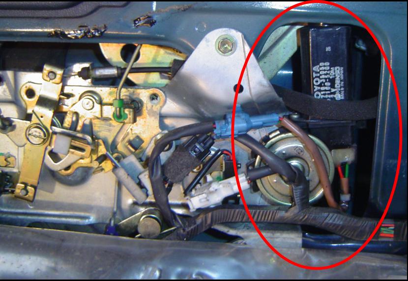

                    It is fiddly - take the panel off (door closed sitting inside the truck) and put your right hand inside the r/h/s of the opening. Now, best gynacologist hat on, feel around behind the motor. There will be three small bolts holding it on.
                    You may need to make up a special wrench - I did. Undo the bolts and it will drop inside the tailgate - pull off the blue plug and you can wriggle it out.

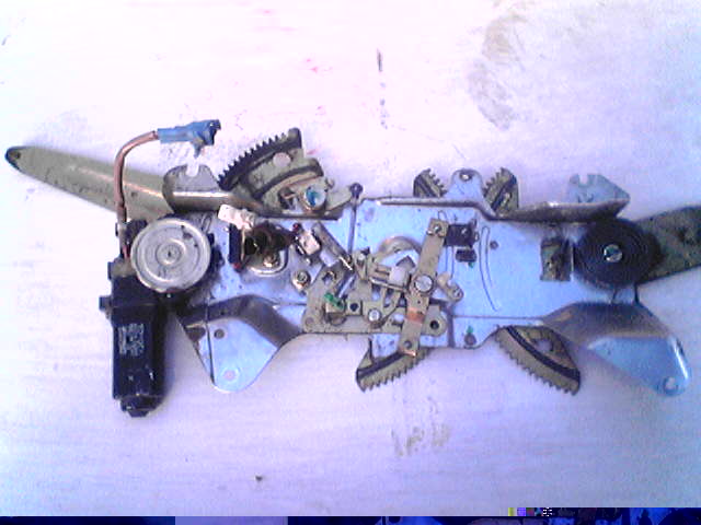

                        Some pics of one I repaired......
                        The first pic shows the regulator, as you can see, nothing much to go wrong.

                            I suspect the problem with yours is the teeth on the white plastic wheel (sprocket) in the motor (second pic) have worn down and causing intermittant meshing with the worm drive on the motor spindle.

                              The middle photo of Vince's shows the iNsides of the motor - it gets filled with rain water and corrodes over the years - then works intermittently.
