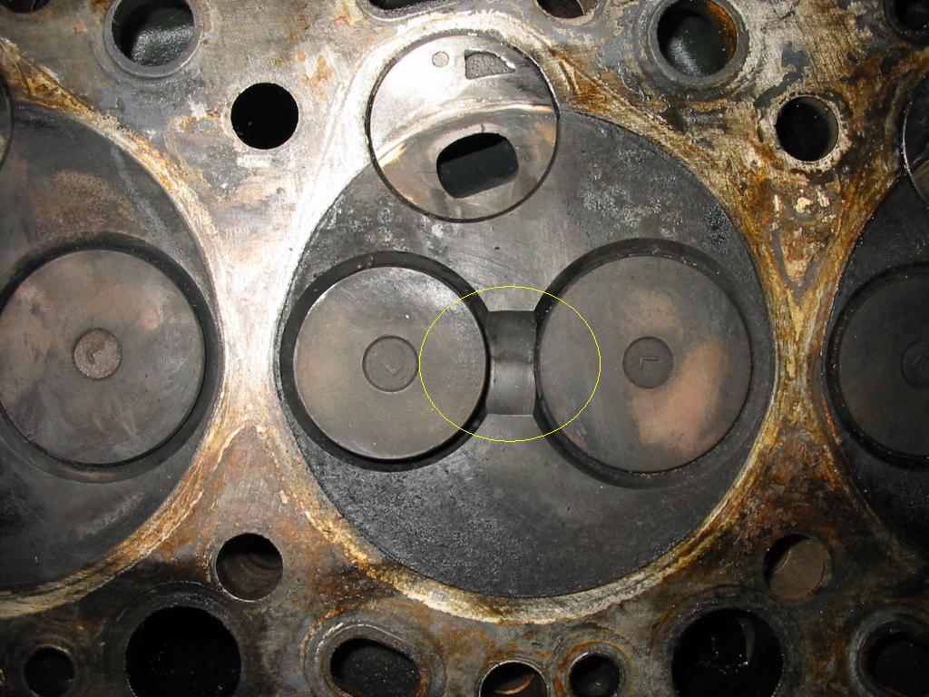

    If its a 2.4 your head may have cracked between the valves so dont assume its just the GASKET.
