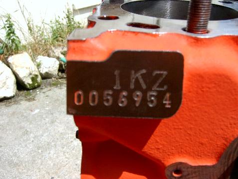

    How can you tell what size an engine is when its not in the car?
    2.4 has the oil filter down low on the drivers side, and the 3.0 has it higher up on the passenger side.
      The 2.4 has a cast iron head, 3.0 has alloy.
        right by no1 cyl n/side under the head should be this
        Tony
          But generally not red.
            come on tony you know you my red block...at least I dont put that colour on the outside
