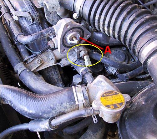

        Here is a pic of the thermostat, the temperature sender is the one circled in yellow.

          Nope. Wrong one. That's for the Temp Gauge. This is the one that supplies info to the ECU and give the fault code.
