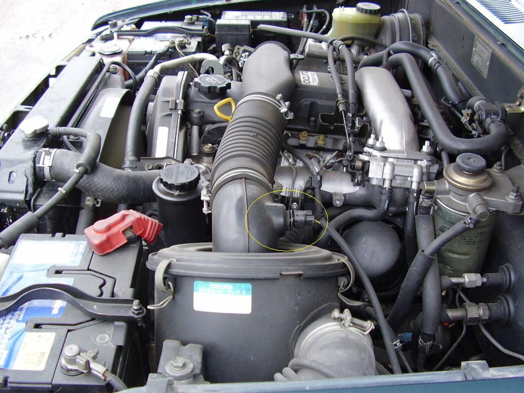

              Also if your green turbo light dosen't come on, check that this sensor is plugged in.
