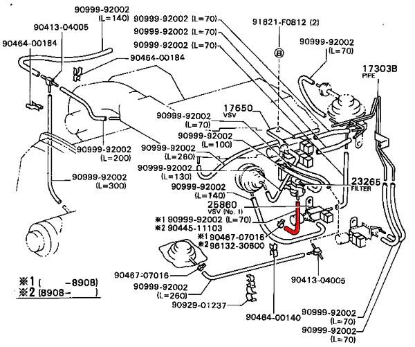

Has anyone got a picture of the positions of the pressure switches and associated tubes please? taken from passenger side under bonnet with little arrows would be nice! Ta.
Hi i hope someone can help? I have a Toyota Hilux Surf SSR Limited LN130 2.4TD on 1990/G plate but the engine has been replaced a few years ago with a 1997 engine i believe!.
The vacuum pipes have been altered to get it through emissions test, since
then it has been really sluggish especially from cold.
I have compared the picture to my engine and some of the pipes are connected differently.
I have attached some pictures of my engine below, can anyone tell me if this picture of turbo/pressure switch pipework is for my engine ?.
Many Thanks
Dave.

I suggest the best thing to do is find another member close to you with the same engine (2L-T) and compare the vacuum hose connections. If you have the non electronic pump with throttle cable and TPS (Throttle Position Sensor) connected to pump then the TPS may be faulty.
Stillwater, your motor should be the same as the pics Marky posted.
Many thanks for your help and NiftyNev found the inlet manifold from my old engine which was buried but all still there, engine was replaced a few year ago as said in my first post, because it seized due to throwing a crank bearing shell. could of rebuilt i suppose! but opted for a repacement engine at the time.
Anyway as i said, dug out the old inlet manifold and to my supprise found that there were some parts on it which wernt on my surf and with the help of the diagram supplied by Marky was an exact match for what i needed to do.
So proceeded to dismantle my pipework to the pressure switch's in order to rectify the problem. followed the diagram and all went back as it should all pipes connected to the right places!!
Took it up the road for a quick test and noticed a definate improvement more responsive engine and better at pulling away and did'nt see much in the way of smoke coming out the exaust
will do some more testing to be sure but all looks very well at the moment.
