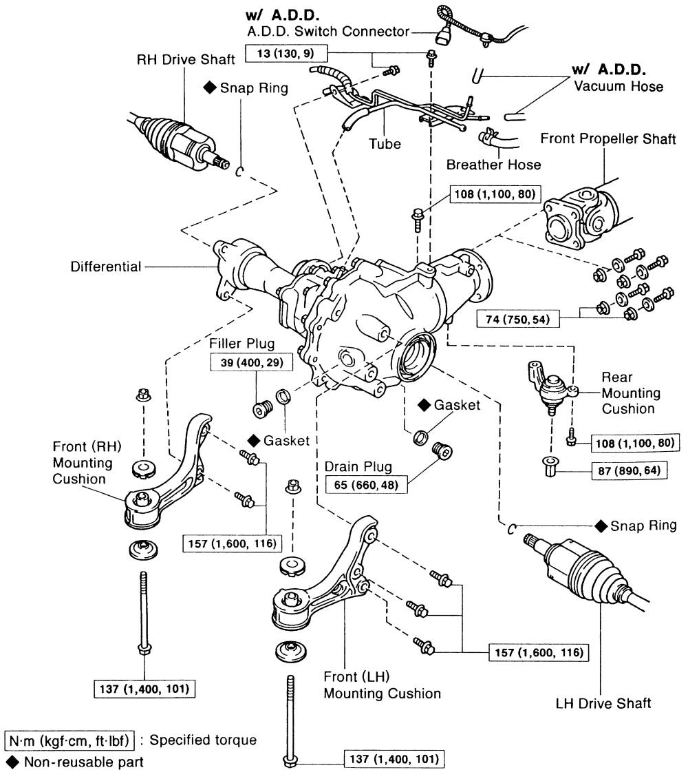

    does anyone know how to remove the half shafts from the diff centre. doesnt appear to be snap rings but i'm not sure. ****** things are gettin the better of me at the moment and any pointers would be greatly appreciated.

        This might help.
          ty for that andy. my diff is unfortunately different to that one i.e. it is a sort of welded top and bottom half affair with the cover on the front face of the diff. i cannot see any snap rings in it. sorry for being difficult!
