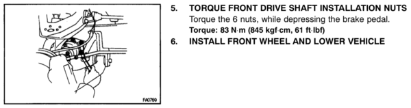

    Hi guys, just replaced my CV boots and wondered if anyone knows the specified torque for the 6 nuts attaching the inner tri-bearing housing to the gearbox? I have been thumbing through the Ellery book but can’t seem to find it there or in walk through a on here.

      Here you go – 83Nm according to the manual

        Hi Galooph,
        Thanks very much for that! You’ve been a massive help .
