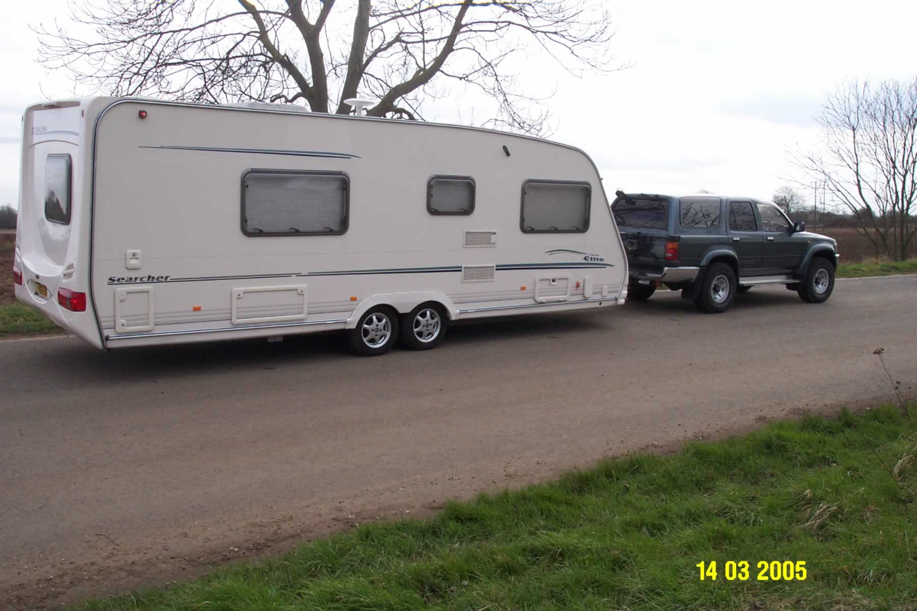

                  Originally posted by marky
                  As you have a twin axle as i do, i keep the weight over the axles. Remember nose weight includes your gas bottles & anything else you keep in the front lockers.
                  was towing this the other day awning on the axles and towed spot on
