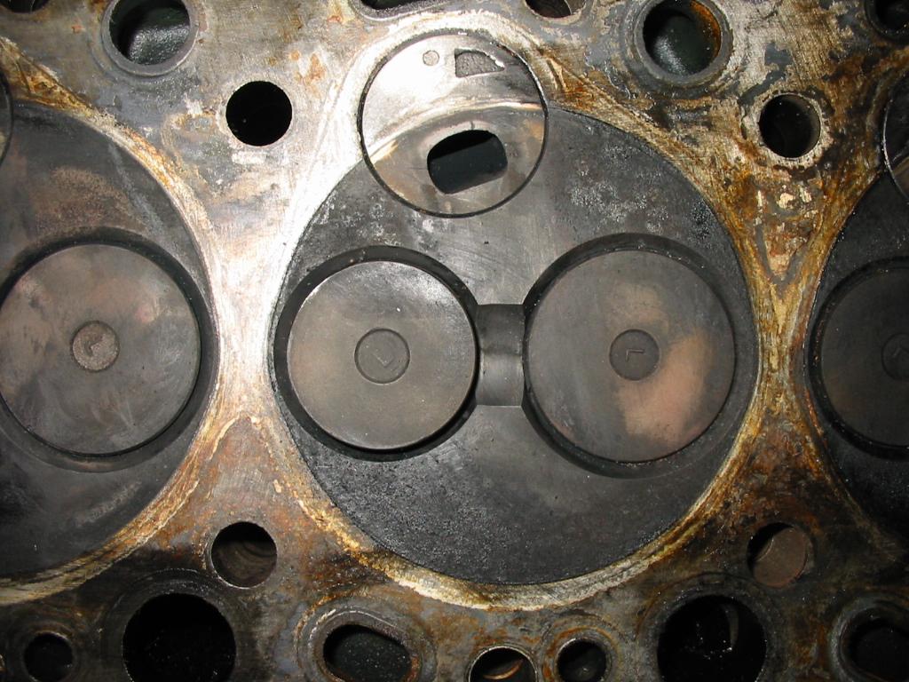

          block
          Jim, the pre chambers are fitted in the new head, i was refering to the area on the top of the block where the head gasket takes the shape of the pre chambers, its important that this area is spotless, look on Marky's pics taken for his mate Paul and you will see where i mean.
          Regards Steve.
            like this one
              Ah, OK - thanks. Just one problem - I'm not allowed to expand that first image. Marky - any chance you could email that image to me ([email protected]) please?
