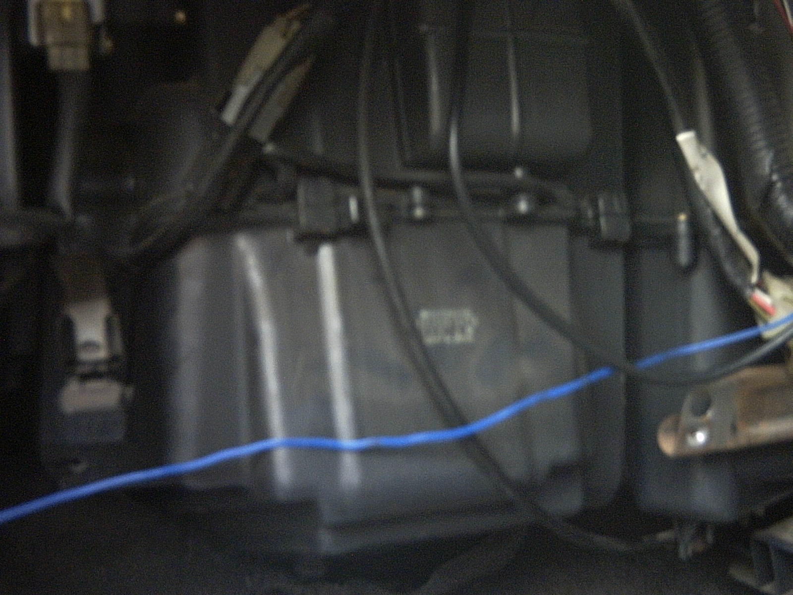

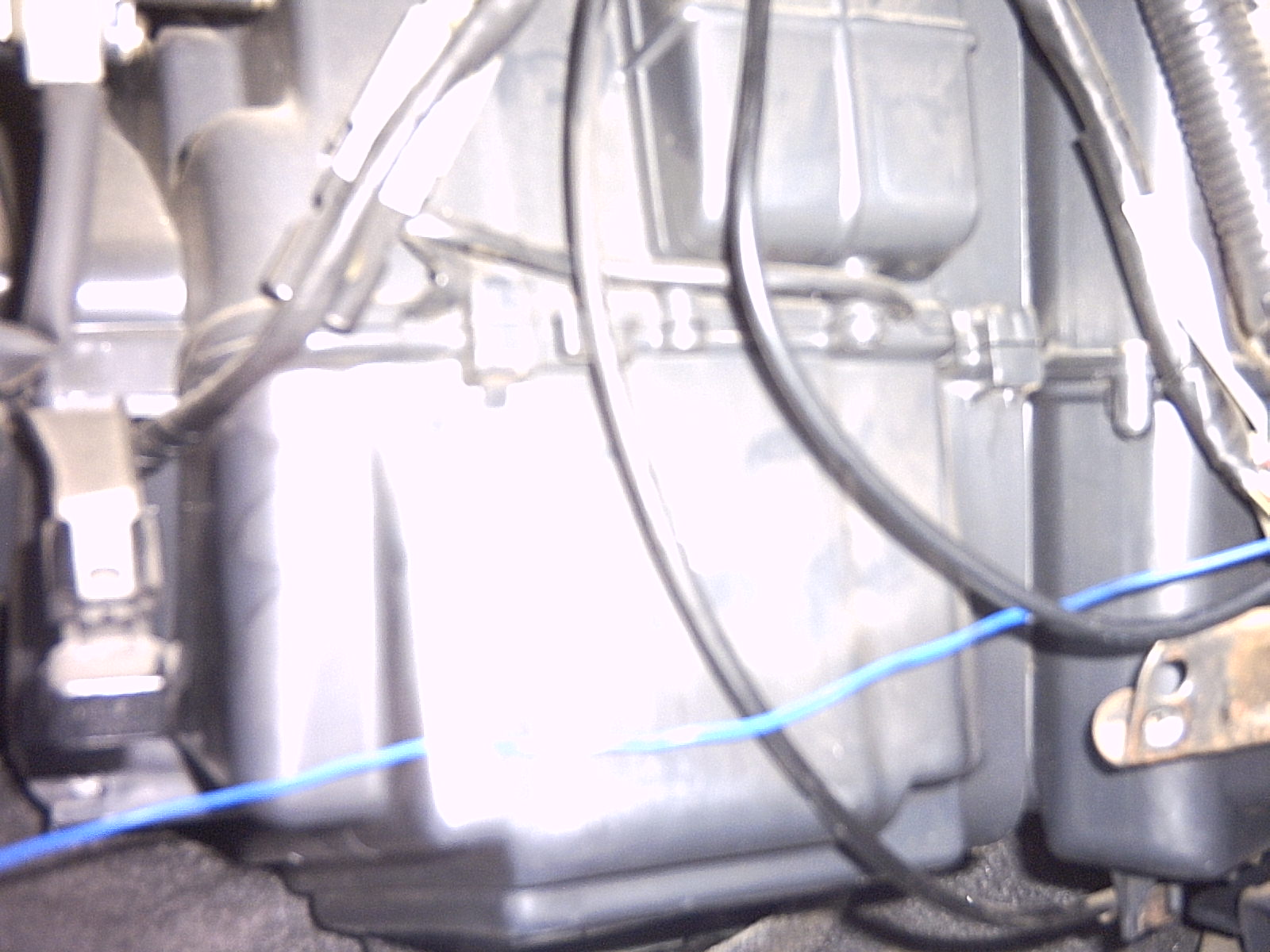

                  can anyone tell me if this is where the heating matrix is hidden behind. when i loosened the bottom bolt there was a brown liquid leaking from it. This is in the passenger footwell.
                      I think the first box is for the air con the next one along (more central) is the heater matrix.

                        sorry but never removed one before,when i have removed the plastic cover will there be a radiator type thing behind it with hoses attached . then will this unbolt from the bulkhead.Thought i had better ask just incases i do somthing wrong as i cannot be off the road for long as i work twilight shift a no buses at 3 in the morning.
                          The hoses are atached to it through the bulkhead. If you look under the bonet you will see 2 hoses going into the car just behind and above the engine. If you would like a bit more info call me on 07740 337153.
