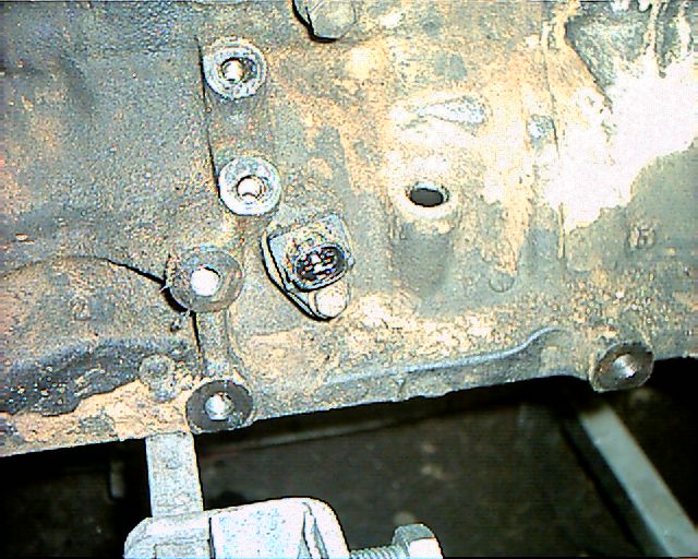

    See piccy, sensor just above sump level on drivers side. what is it?
    New engine has no place for it old one did as you can see.

    It is the crank angle sensor ( an absolute must for the EFI to work ).

      so looks like they have sent me wrong block ie not a efi model then.
      No way round it then.
      Steve
      Should have bought a 3ltr
        The HIACE engine is similiar to your new one. No crank sensor.

                  Basically I think I got a MFI block as opposed to an EFI.
                  Ivor searle accepted full responsiblity for suppling the wrong motor and said as it was a grey import they should have asked more questions.
                  However as for all work carried out so far ie building the motor they weren't liable as their fitting manual quite clearly states " check for compatability before instalation"
