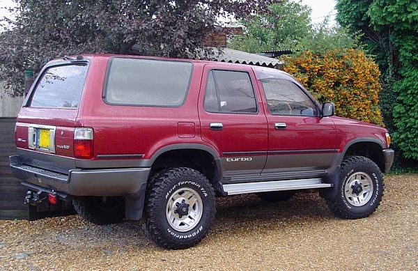

              Here's a '91 narrow body on OE alloys with 31/10.5x15 BFG mud tyres. Suspension untouched since import.
              Looked at head on the tyres stick out about 1".
              David
                David
                had them on my narrow body 31 x 10.5 x 15 MT's
