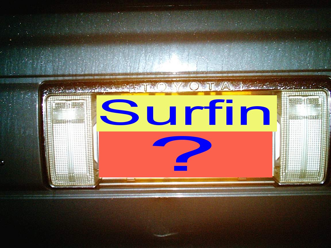

I had thought if I change my reg to a long one instead of a square one (in the pic below “surfin”) then I would have all that space to fit (in red in the pic)??a spot light of some sort and link it into the revering light wiring.

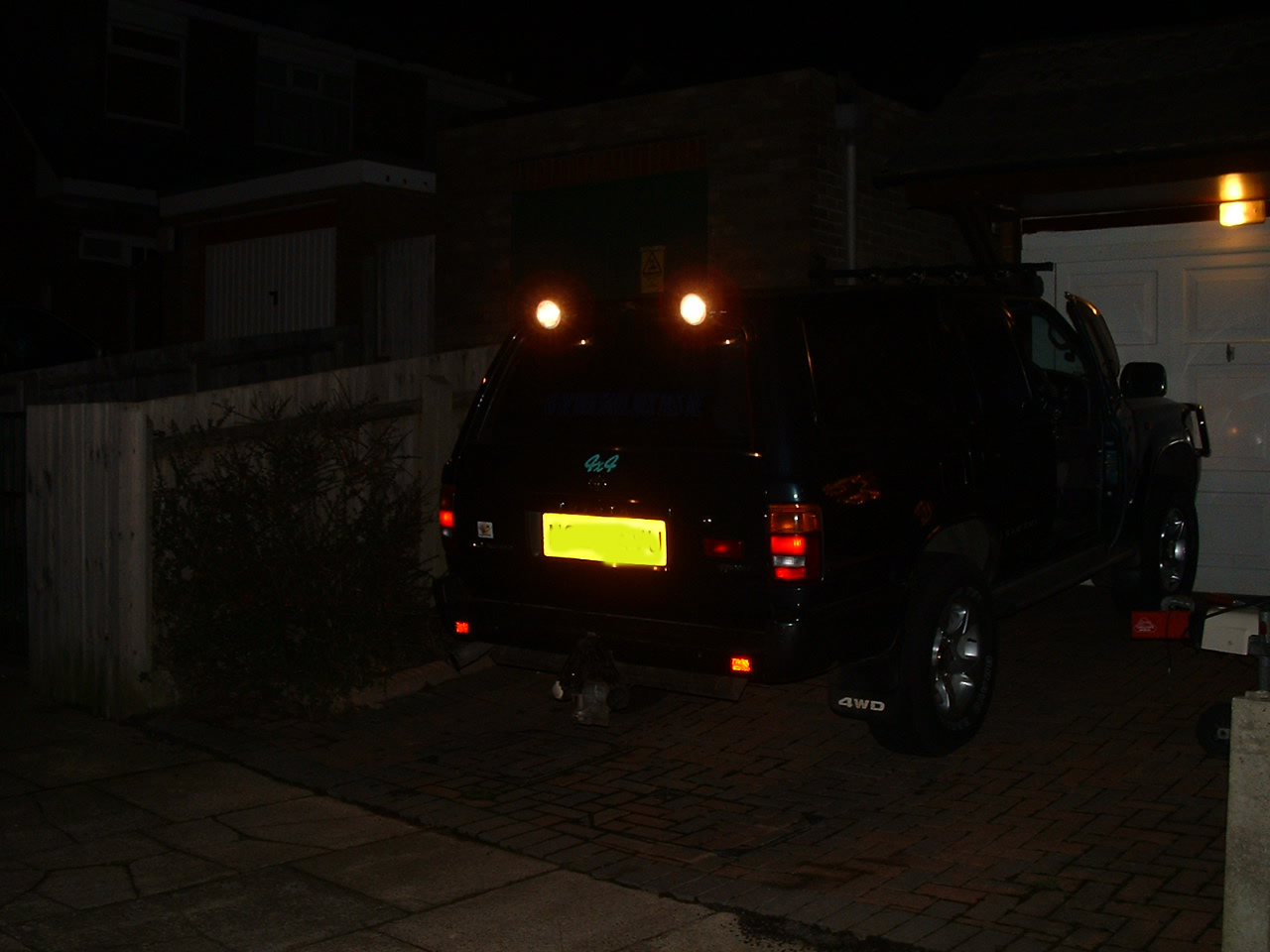

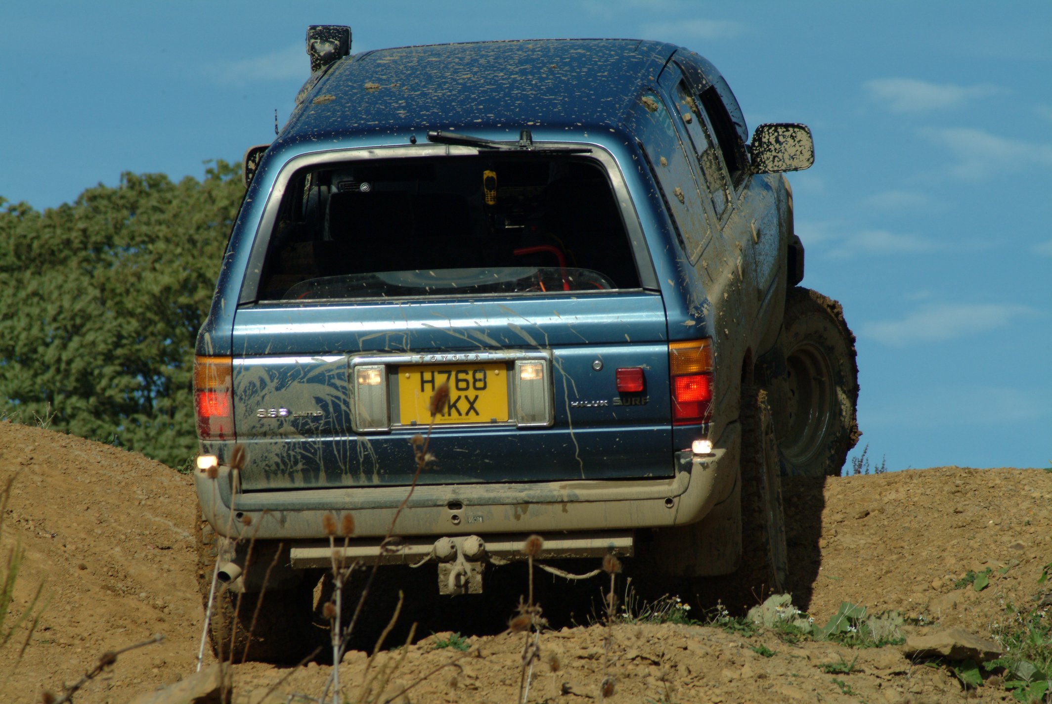

broke that twice in two months!! so cut two into the bumper(much better)

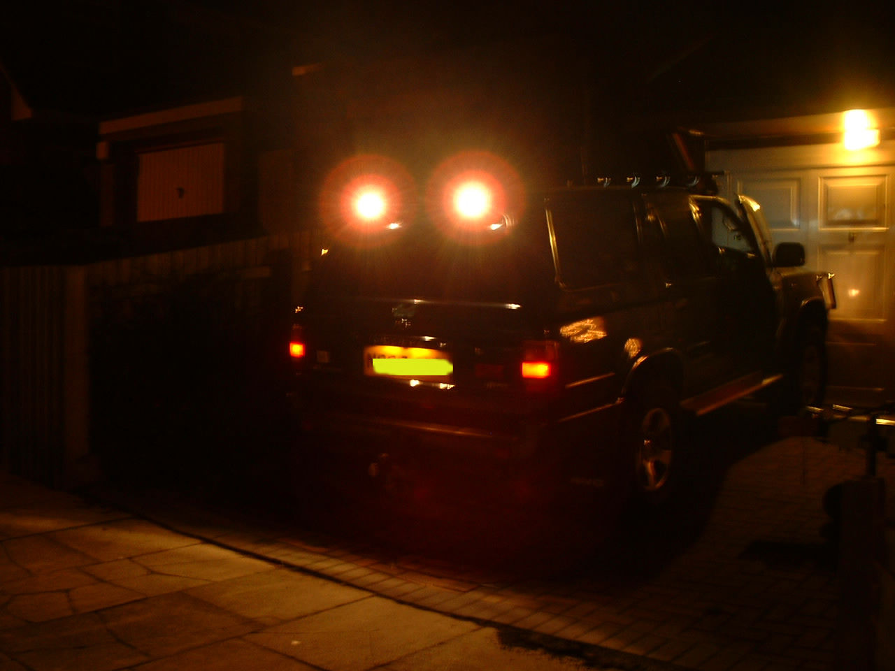

. Operated via a relay and come on with the reversing lights. I've also got a switch in circuit so I can turn them on as work lights.
