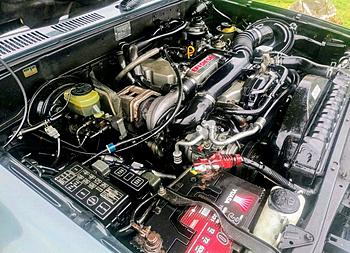

    Hi, can anyone tell me the location of the oil pressure switch for the 2.4 TD 2L-TE please.
    There's no oil temp switch for the engine. Do you mean pressure sender?
      Yep, my mistake... Oil pressure sensor.
        Rearwards of the oil filter in the oil cooler housing. It's a sender for the gauge not just a switch. Switches simply operate a dash light.
          Is it connected by an electrical connection or a pressure pipe?
            Electrical. There's a wire from alternator harness that goes to it.
