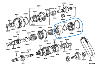

    Hi. how can i find out what model my transfer box is and a manual on how to disassemble and rebuild it.
    i have a toyota surf 3rd generation 07 1996
    Google VF2A Transfer Case unless your Surf has a centre differential, which I doubt you have.
      Thanks but that model planetary gear set as mine. Here is the part that is broken in my box highlighted in Blue a picture i got of Amayama
