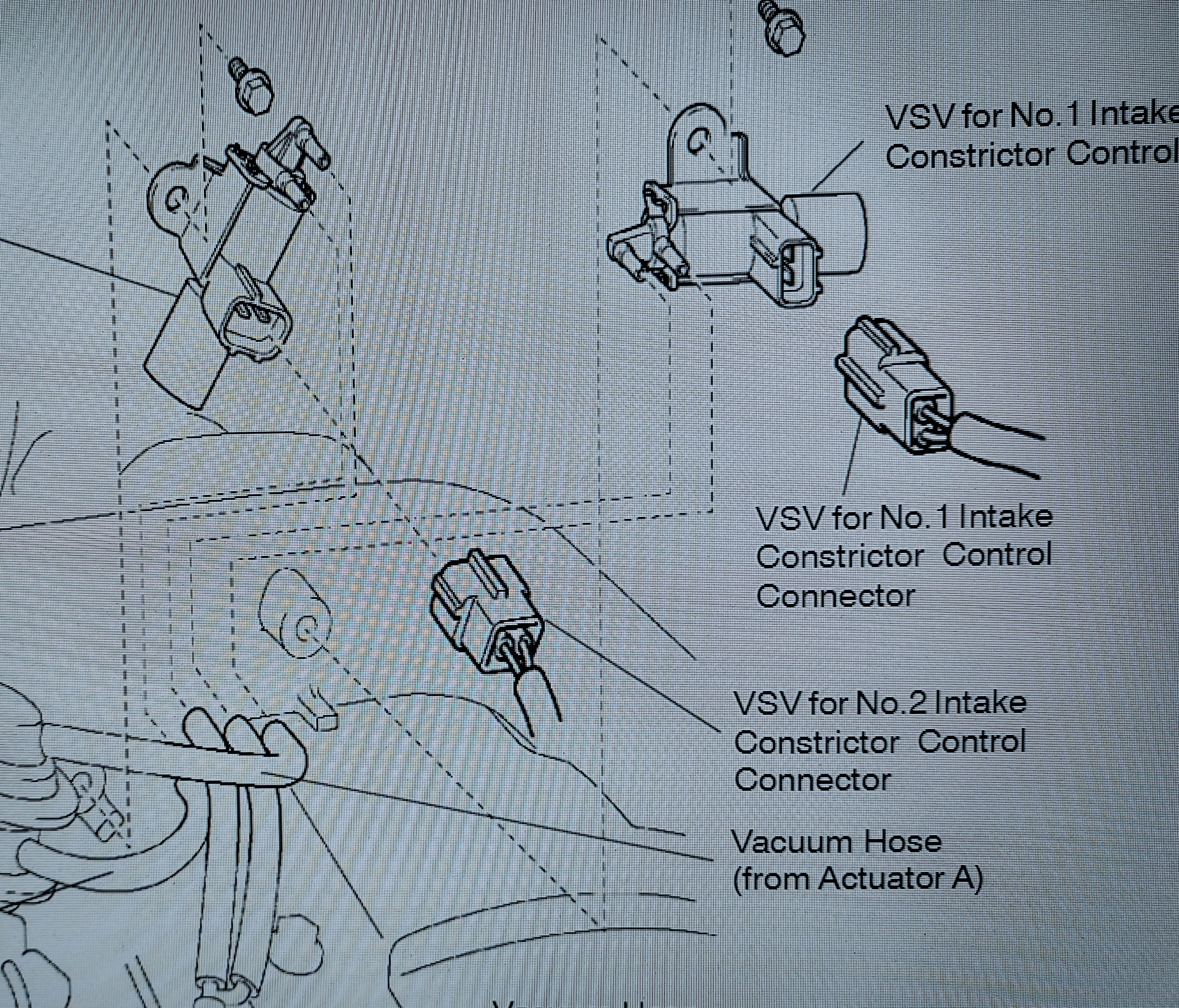

I have identified that one of the VSV Intake Constrictor valves is not working, Wiring is good, connections are good.
Can some one give me specifics please on:
1.) Are they both of the VSV's exactly the same part # do they do the same thing, (just on different circuits)?
2). I would think the computer is telling them to open at different times, correct?
3.) What is the voltage that is needed to operate them? ,, I get about 8 volts just above idle on the one that is working correctly.
Following the diagnosis that I found on line, the one working properly does not pull vacume at idle, then just above idle it pulls vacume. The #1 VSV does not work in the same manner, even though it works when I bench test it and give it 12 volts it opens and closes. But when it is in the car it will not open like it should, just above idle.
4.) What is the correct part number for the VSV Intake Constrictor Valve for this engine?
5.) Who will sell it to me and ship it to the USA? if I cannot find it here,,,,,it is a 1994 turbo Diesel 4WD Automatic.
Kinda stuck I hope I gave enough information for a expert to answer here on this forum
6.) Here in the USA I have not found a good place to source parts and information, any ideas?
So to make it work "good" for now,,, I put both of them on the same vacume circuit,,, so I Tee-ed one vacume line to the other vacume line (on the side that opens from a signal from the computer). and it works but I believe this is not the right way to fix it and that is why I am asking all these questions?
7.) Is there a good source on the internet for diagnostics for information on how this part of the sytem works?
